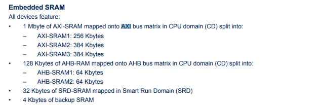

MM..1
MM..1Best answer
Nov 28, 2022 6:39 PM UTC
No correct, your framebuffer RGB888 is 382,5kB perfect for SRAM2 and second buff SRAM3 (kB = 1024B)
But you can use RGB565 or L8 based on your graphics.
11 replies
MM..1
Nov 28, 2022 5:03 PM UTC
Your resolution and MCU power can do animations maybe too with single buffer only. Some screen transitions require triple buffer... And RGB888 is required only if you plan show photos or perfect gradients.
Plus need care SRAM isnt one piece 1,3M, but more parts. Only some usable with LTDC.
Accept all this your logic is correct.
KMew
KMewAuthor
Senior III
Nov 28, 2022 5:22 PM UTC
Hello MM,
Thank you for confirming this. I did a quick search in the datasheet and found the following:
It does seem the AXI SRAM is broken into 3 parts. None of which are big enough, based on my previous calculation.
So based on this, it is not sufficient and external RAM would be needed, correct?

MM..1
MM..1Best answer
