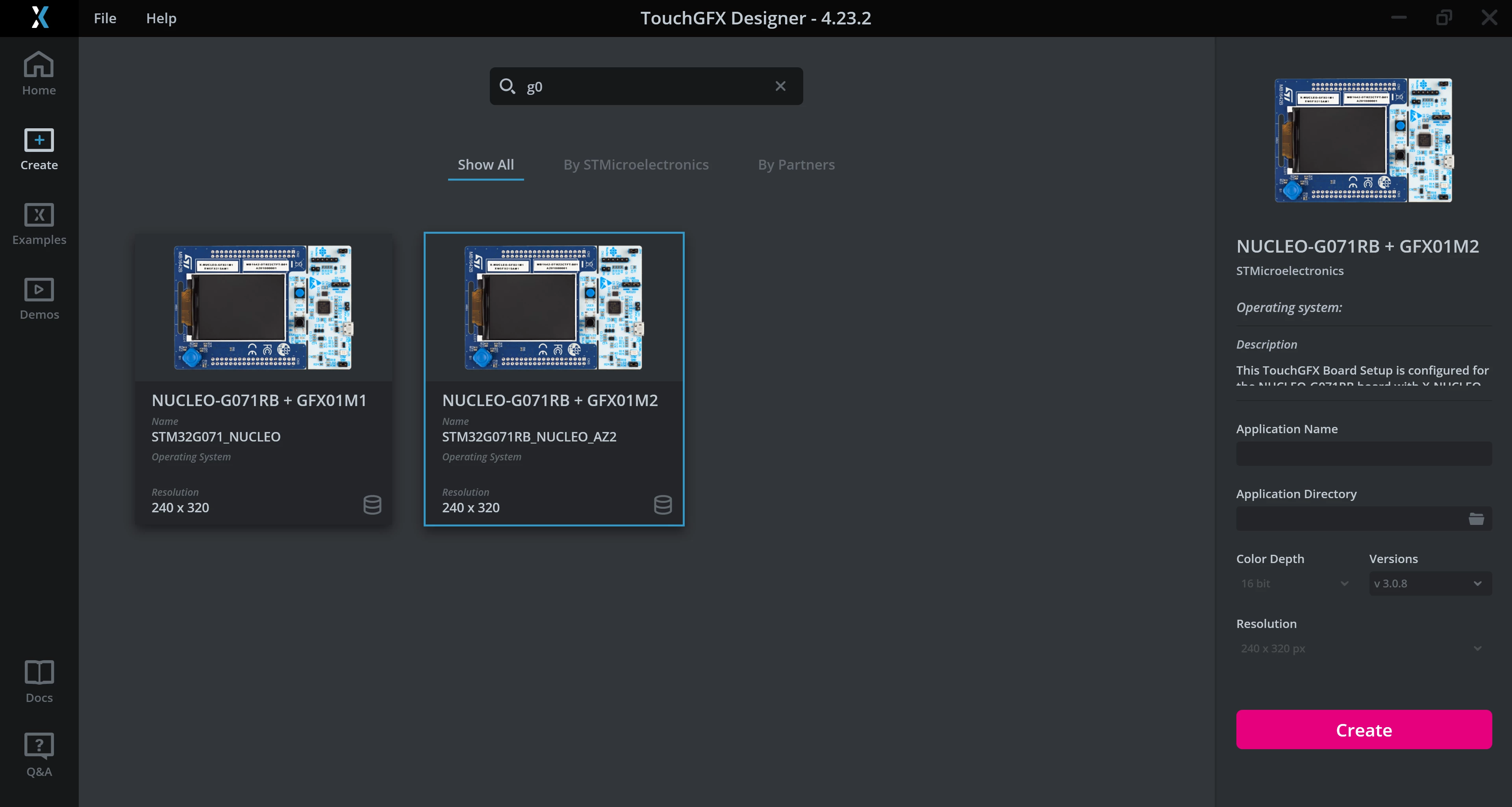

Hello @jasonlee3 ,
I'm not sure if you are planning on using graphics on your board or not, but I suggest using TouchGFX instead of your current project.
TouchGFX has already a Board Setup which contains all the required settings for NUCLEO-G071RB + GFX01M2; You just need to develop your GUI and the rest in handled by TouchGFX.
 TouchGFX Board Setup for NUCLEO-G071RBTouchGFX Board Setup for NUCLEO-G071RB
I hope this helps you, don't hesitate to ask more questions
