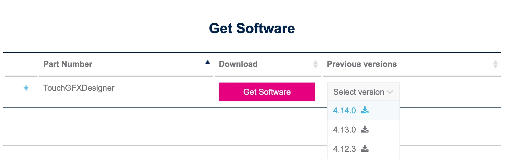

Where can I get 4.15 ?
The download is only shows 4.14.
SPang.1
SPang.1Author
October 15, 2020
Managed to install Designer 4.15 and got a button and new screen working on the simulator. Generated the code.
