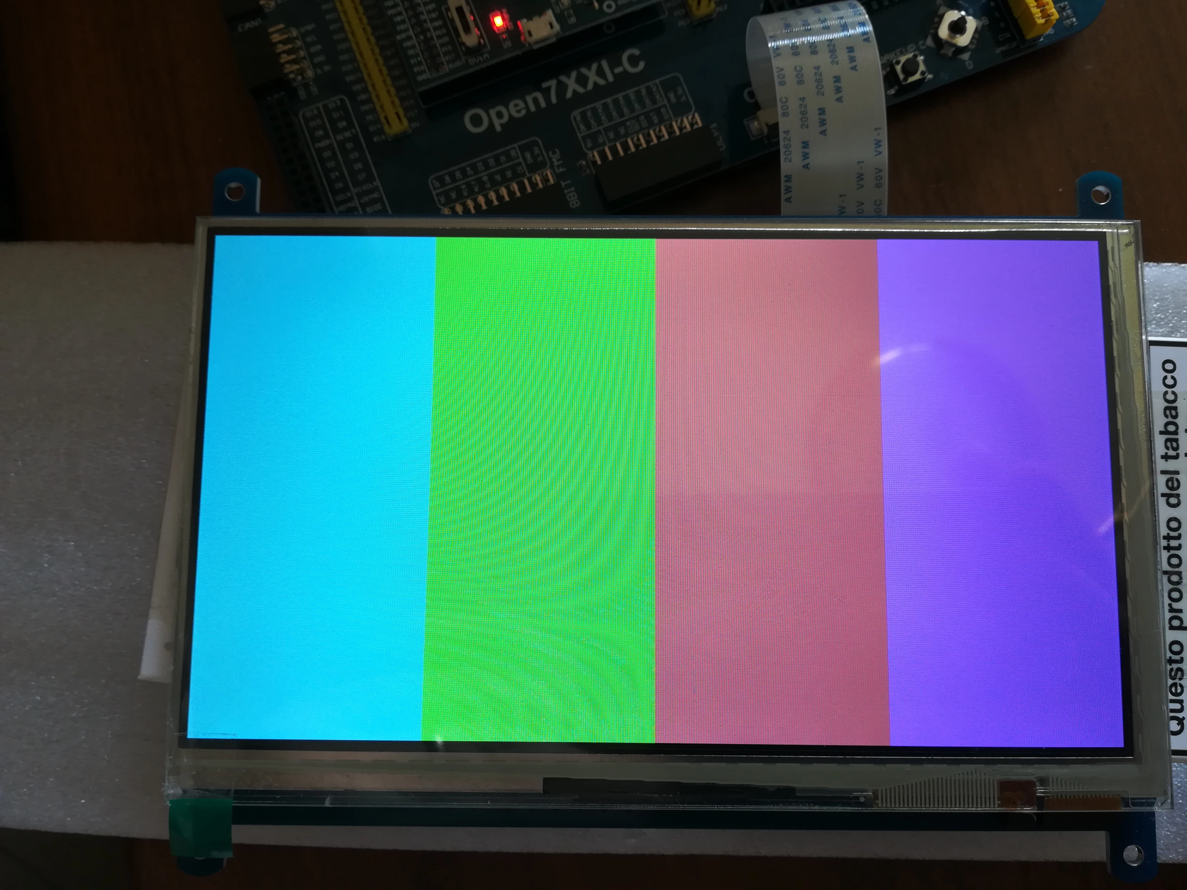

ALomb
ALombAuthor
Senior
July 10, 2019
Hi @Martin KJELDSEN​ ,
I create a new project in CubeMX IDE for my board (WaveShare Open746I).
based on a working project I configured:
SystemClock;
FMC;
SDRAM (mapped to 0xd0000000);
LTDC;
DMA;
DMA2D;
CRC;
I also created a simple application through the TouchGFX Designer.
This is what I see on the LCD
What could be the problem ? How to debug?
Through debugger, if I try to modify the frame buffer in external memory (0xd0000000) I see the changes on the LCD correctly.
Best Regards
/Antonello
