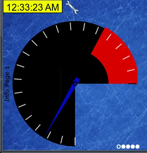

I was able to get some code to iterate through the collection of shape widgets. This code will work because all my child widgets are of the shape type.
I was still not able to access the color of the shape as it is a different object of a painter.
But this is a step in the right direction...

I've included what the widget (gauge) looks like at run-time.
I'm shooting for a dynamic widget that the user can set the size of the gauge at run-time. They also need to set the max limit of the gauge, hence the ability to control the ticks.
