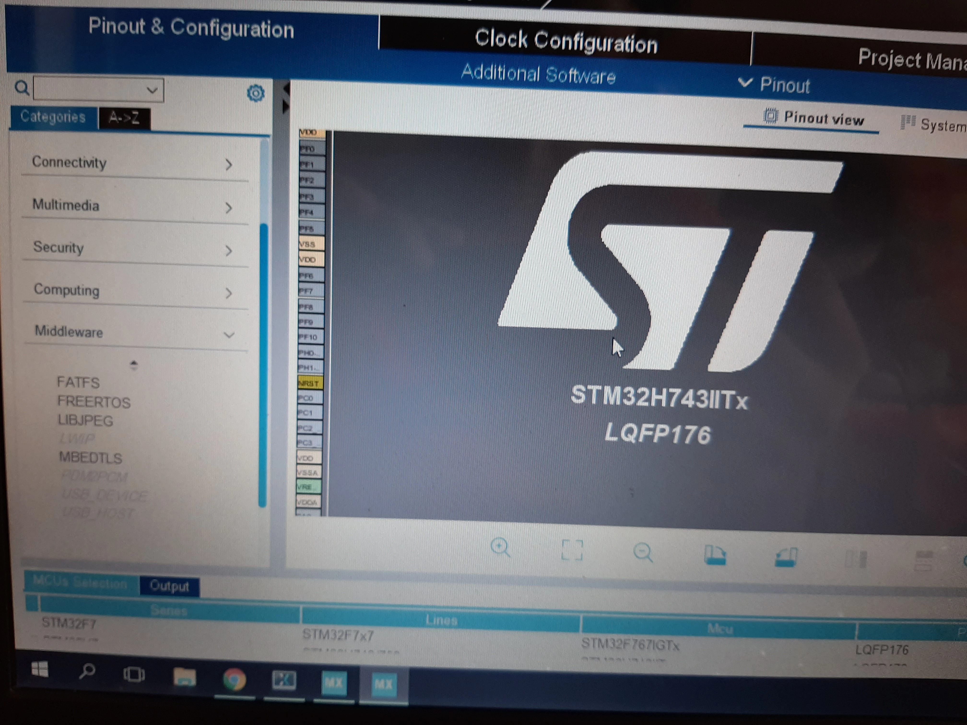

I not found graphic part​ for stm32h743i & h750 in cubemx. Why??
This microcontrollers don't support touchgfx??
​how I will be using touchgfx in my h743 board??
In the meantime the stm32h743i board is my own design and construction.
Thank you for your guidance.

The option is currently not available for H7 mcu's. But you can create a basic project in TouchGFX Designer for the h750. Then create a project for the h750 with CubeMX in CubeIDE. Then transfer the TouchGFX files into the CubeIDE project.

As @hansd56​ correctly states, H7 does not have TouchGFX support yet from within CubeMX (we do have something working in the lab). You can select the H750 application template from within the TouchGFX Designer which uses a specific version of the Cube Firmware.
You will probably need help migrating this application into a CubeMX/CubeIDE projec, but if you want to try let me know.
