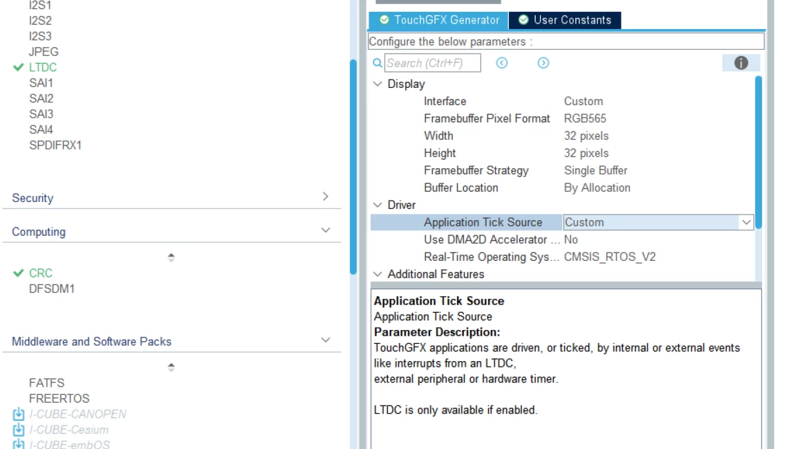

Not able to select Application Tick Source = LTDC, even if LTDC is enabled
[STM32CubeMx 6.8.0 / TouchGfx 4.22]
Hi all,
I am trying to configure the LTDC as TouchGfx application tick source but the CubeMX won't let me even if the LTDC is enabled.
Any ideas? Is there anything else that I should check?
I have already working code from other projects that I could manually integrate but then every time we regenerate the code it will be overwritten.
Thanks,
CMars.1
CMars.1Best answer
Sep 1, 2023 6:07 PM UTC
How silly of me. I forgot to select LTDC as display Interface.
I guess it's time to power-off the computer :)
