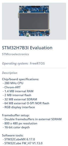

    May 15, 2026 8:39 AM UTC
    Since the memory questions are unrelated to the topic of this thread, I would recommend creating a new ticket for clarity and visibility.
    However, to answer briefly, I would first recommend reviewing the description of the TBS available in TouchGFX Designer. From there, you can see which memories are initialized and used in the TBS. As shown, the SDRAM is e.g. used for the framebuffers:
    As a next step, you can review the map file to see what goes where.
    I would also recommend reviewing at least this article in the TouchGFX Documentation: https://support.touchgfx.com/docs/basic-concepts/framebuffer
    Best regards,
    Johan

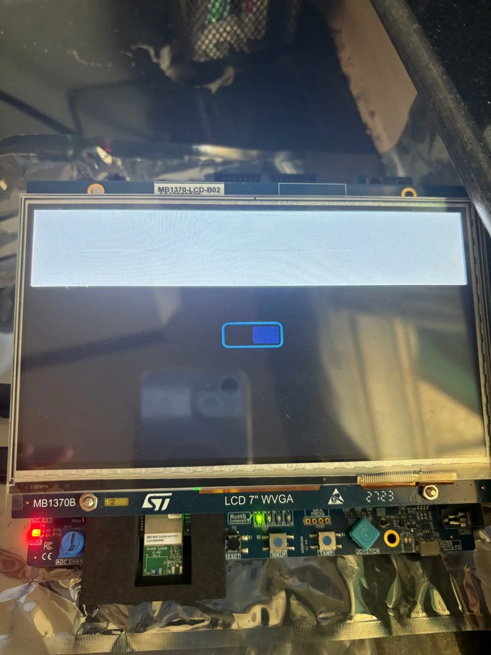

    Oct 28, 2026 8:05 AM UTC
    just check this attached files on your board i had try it but it given me issue in pixel form for stm32h7b3-EVL
    The board revision I am using is MB1370-lcd-b02 a254300030.   the custum created project work properly wrt  Touch screen method but the exixting code didnt work properly TOUCH GFX  4.25.0 version created all custum application work.  TOUCH GFX 4.27.0  given issue with custum application projects give me solutions for it . i was share my files
    Vijaya
