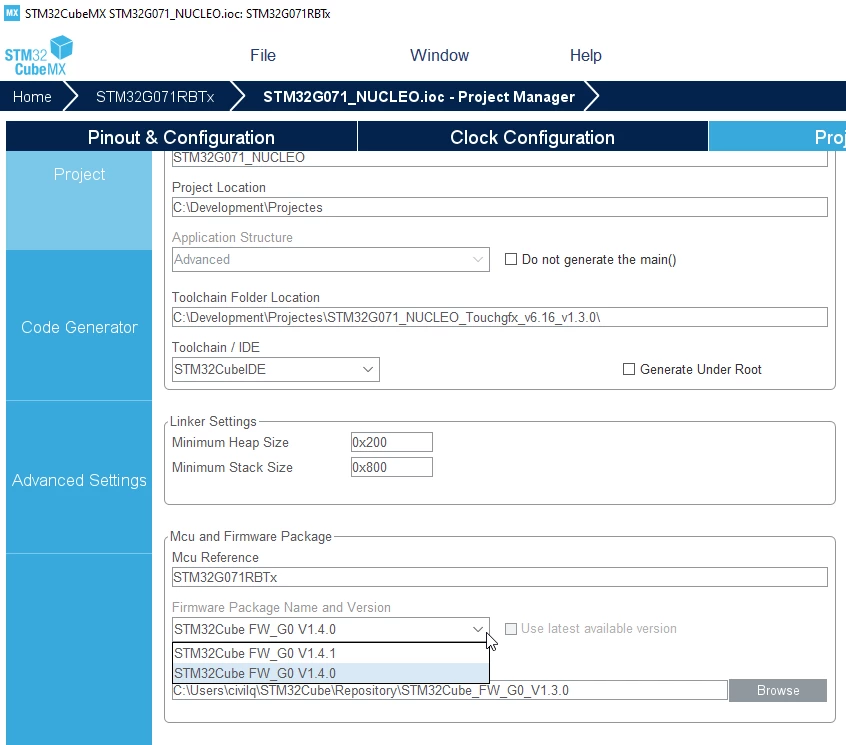

I have te package STM32G0 v1.3.0 instaled but it doesn't let me choose it, only v1.4 and v1.4.1. Can I do it choosing the frimware location manually from STM32Cube_FW_G0_V1.3.0?
I made a new copy of the original working project and I browsed the location manually, but frimware package name and version don't change I don't know if it is using the right firmware...
0693W000008x7ZrQAI.pngI generated the files and then the building error didn't show and compiled with no errors, but when I flashed the nucleo the same happened, the texts don't show up.

By browsing to the v1.3.0 folder you will select the right FW package, I agree that it would be better if it was written if you are using the one you want or not.

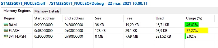

Could you share a screenshot of your error ? When I try to run your project that is not working from TouchGFX Designer I get an issue with the external flash. Is it the same for you ? Could you check your memory usage (what IDE/toolchain are you using ? STM32CubeIDE?) ?

Yes, I used CubeIDE, ​I didn't had the memory issue, it complied with no errors. Maybe I uploaded the wrong project, on Monday I will investigate that. But if you replicated the problem with the other project, that is my main concern.

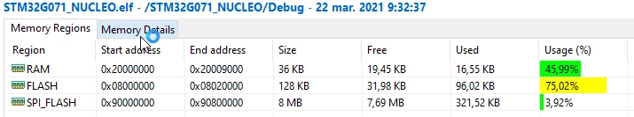

I downloaded the not working project and it compiled with no flash error in my computer, with CubeIDE.
0693W000008xX6cQAE.pngWith the working one I have a little less memory usage, and the only difference is enabling uart1 on cubeMX and regenerating as I said. I don't know if that is concerning.
