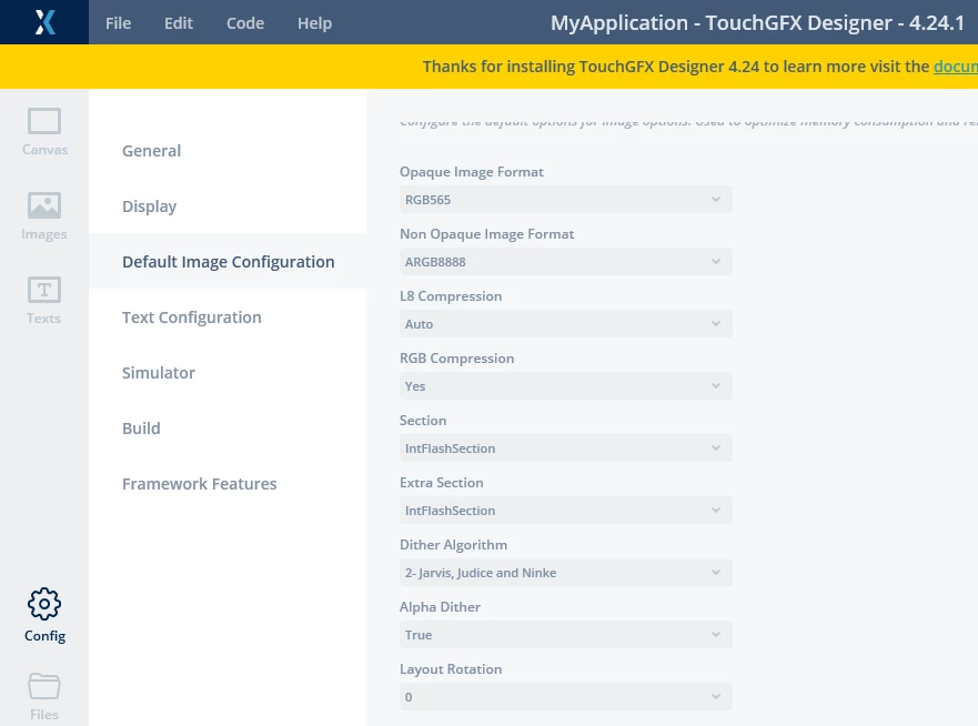

  • The images and font is placed in the internal flash as there is no space constraint for my application. ( Most of the demos or examples use external Flash for images and fonts).

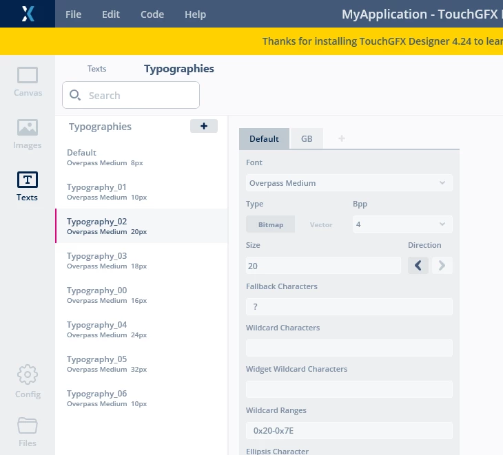

  • Using a custom Font for my application (default font Verdana didnt work as well)
so the settings considered are as follows

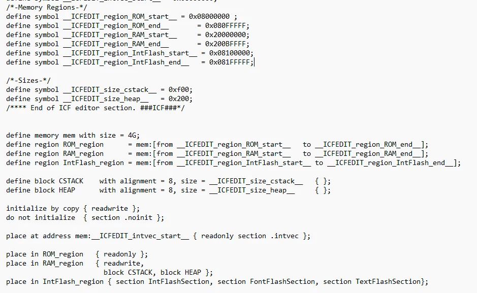

  1. The *.icf file image
    2. the settings in Touchgfx

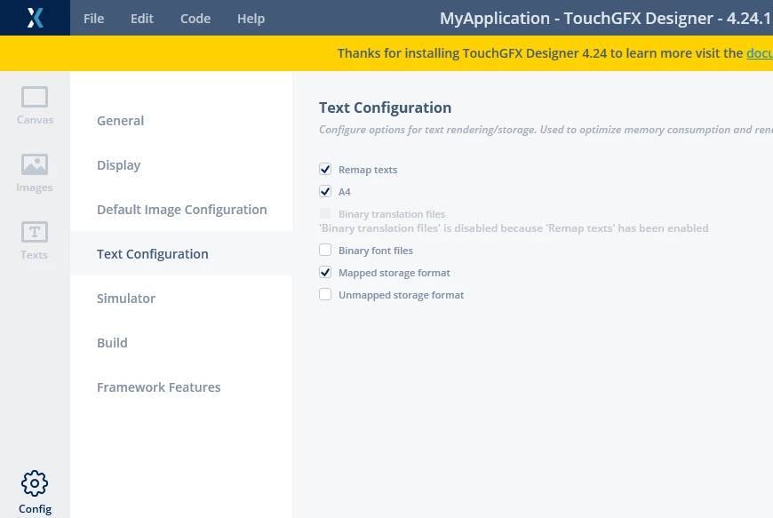

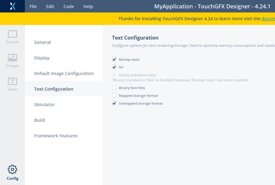

  • With the setting to unmapped storage format in Config, the images are getting displayed on the screen and switching of the screen also works fine. (No text is displayed on the screen)

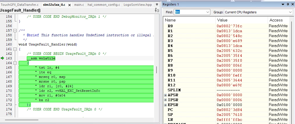

  • Since the texts are not working for me. I changed the setting to mapped storage format. After this change, Usage fault is triggered. From the CPU registers., the fault is triggered as soon as the font information is being fetched to display on the screen.

So the current setting in the project under Config tab in text is SET to unmapped storage format.
Yes., the text boxes are all set to visible.
From the touchGFX simulator i get the below image as response (considering no build issues when compiling the text/font)
The same generated code by the designer is flashed to the hardware and the result is as below
If observed., the simulated image has texts but the same is not seen on the display.

It looks like the font glyphs are not being generated in the IntFlashSection. Please change back to Mapped Storage Format, build your project and attach your Map file.

Hi @Michael K I have now changed the touchGFX setting to MAPPED STORAGE FORMAT and it gives a usage fault. Adding the snapshot of CPU register window and the map file in the zip.
Let me know., if any other suggestions/ settings have to be considered.

Hi All.,
In my application, the usage fault trap is enabled that is triggered at divide by zero and also when the memory alignment fault is observed.
By disabling the memory fault trigger that is enabled at the usage fault. I was able to get the fonts being displayed on the screen.
This solution helped me come at a conclusion saying that memory alignment at the Font data level is not correctly working at the touchgfx library level.
The core is M33 of STM32U575V is unable to handle it accordingly. Still working on it., as disabling the fault enablers at the handler is not the right way to handle the issue.
