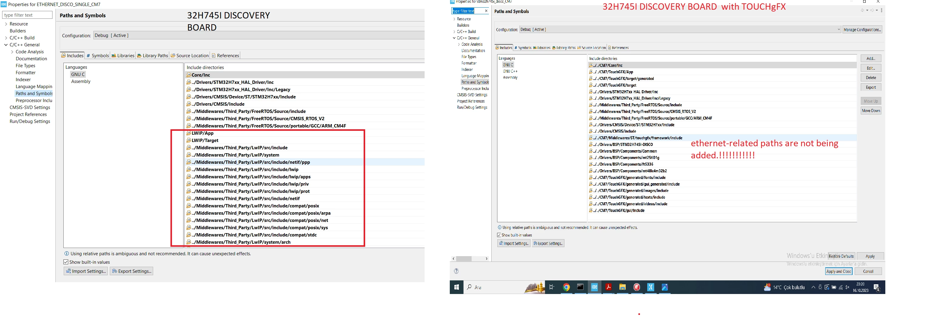

No such file or directory ERRORS
I created an empty project with TouchGFX. immediately after, when I activate and compile Ethernet and LIWIP modules via the CUBE IDE, I get the following error: Description
fatal error: lwip.h: No such file or directory main.c/stm32h745i_disco_CM7/Application/User/Core line 23 C/C++ Problem.
When I create a project with Freertos without TouchGFX and activate and compile Ethernet and LIWIP modules in the same way, it adds all the paths to the project.
TouchGFX version: 4.21.3
   CUBEIDE versiyon:  1.13.2
I uninstalled and reinstalled the CUBE I DEVE Touch FX compilers, made all the updates. but I'm having problems when I create the project with TouchGFX before.

i tried to manually add non-existent paths related to the problem I mentioned, but I got meaningless compilation results that continued with different errors.
