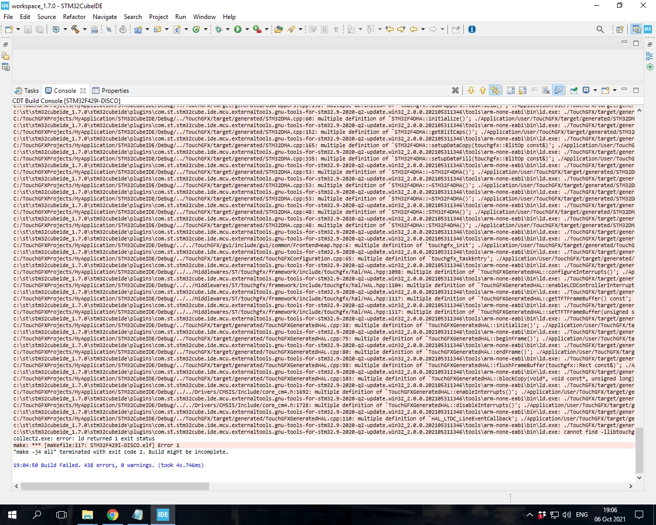

Hi TDK I have since resolved that issue. However I am faced with complilation errors. Please see the image below:
Andrew Neil
October 6, 2021
would be better to copy & paste the text - your image has truncated the messages.
Fortunately, when you get loads of messages like that it's often down to just one problem (or a few problems) - fix them, and all the messages will go away.
The key is to address the earliest-reported message first.
