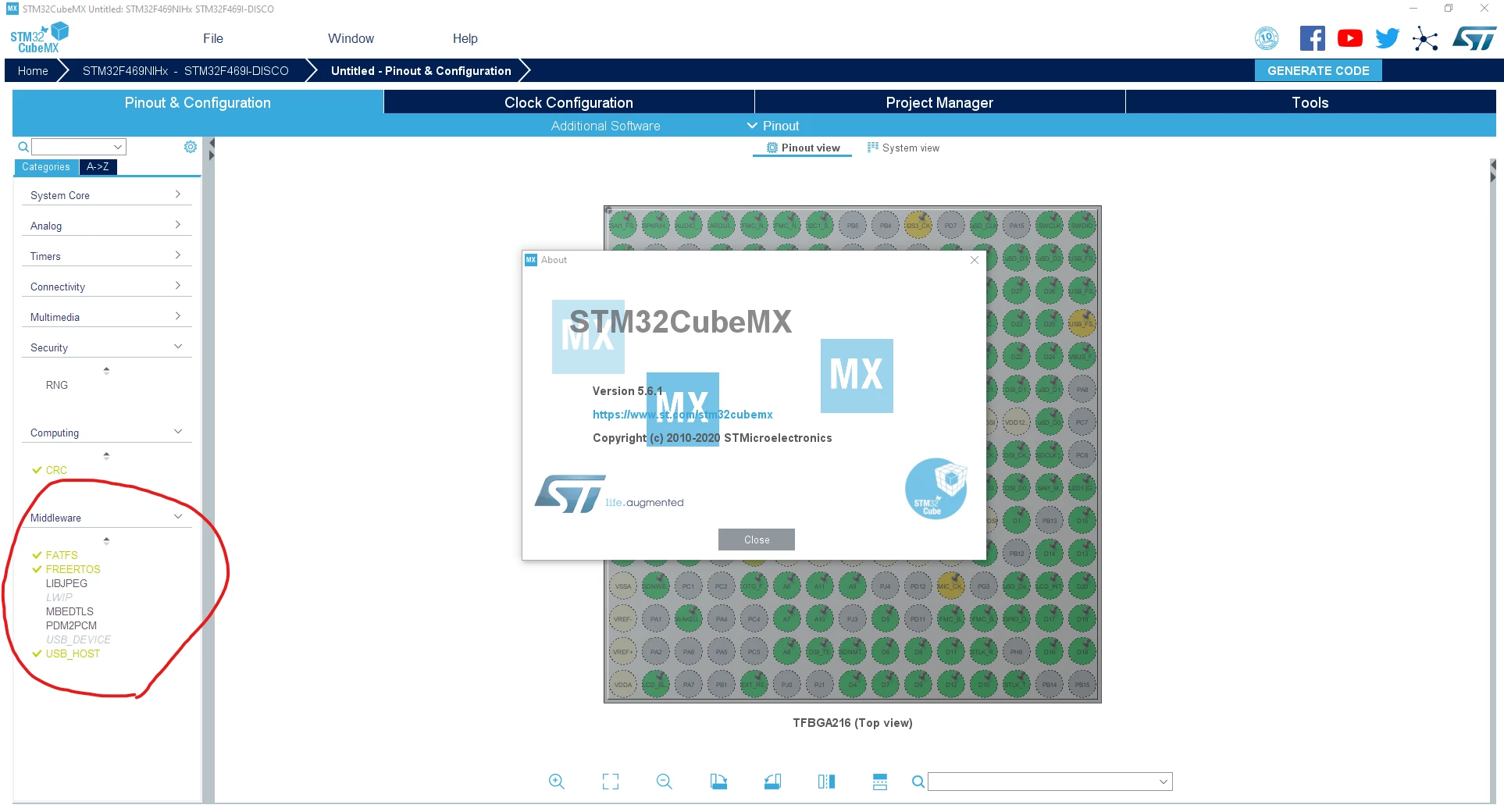

Hi all,
After I have updated my STM32CubeMX to version 5.6.1, I noticed that there is no emWin in under Middleware category. Did ST remove the emWin support in STM32CubeMX?
If anybody knows how to configure in STM32CubeMX, please help me to answer.

​Hello @ATun​
Yes, STemWin is no more supported on CubeMX from the 5.5.0 version.

STemWin is still distributed in the STM32Cube firmware packages (e.g. STM32CubeF4), now you have to add it in the development environment instead.
See the documentation of your development environment and STemWin on how to do it.

Yes, STemWin examples can be found in STM32Cube firmware packages. But in the old STM32CubeMX software, there is a tab for STemWin to configure GUI library. It's now disappear in latest STM32CubeMX software.
