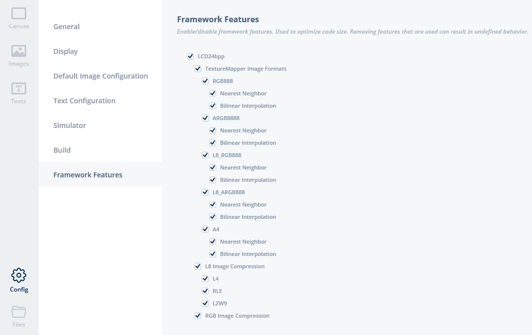

As I tried to use the gauge Widget, the needle doesn’t display on the lcd nor the simulation.
I also tested with the analog clock and experienced the same issue.
Is there anything I need to change in my project configuration ?
I am using an stm32h7a3zi-q Nucleo and a 320 x 240 LCD TFT screen.

Since both the gauge and analog clock widgets use a texture mapper to display the needle, have you ensured that the texture mapper format in use is enabled under Config → Framework Features?
Best regards,
Johan
