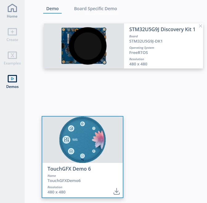

Need the default demonstration program of STM32U5G9J-DK1.
We have procured a STM32U5G9J-DK1 discovery kit. We are in need of the default pre-loaded program that comes with the kit as this will help us to understand how to use Touch display and its other features. We see that this pre-loaded program is not available in the repository downloaded for STM32U5G. Therefore, request you to kindly share it here.

Hello.
Most of the source code is available in TouchGFX Designer. If you combine the TouchGFX board setup for STM32U5G9J-DK1 with TouchGFX Demo 6, you get most of the Out-of-Box demo for the board.

Hello @Sudarshan
The full demonstration of the STM32U5G9J-DK1 is not available now. You can refer to the examples provided in STM32CubeU5/Projects/STM32U5x9J-DK at main · STMicroelectronics/STM32CubeU5 · GitHub and for TouchGFX demos refer to the demos provided by X-CUBE-TOUCHGFX (X-CUBE-TOUCHGFX - TouchGFX advanced and free of charge graphical framework optimized for STM32 microcontrollers - STMicroelectronics)
