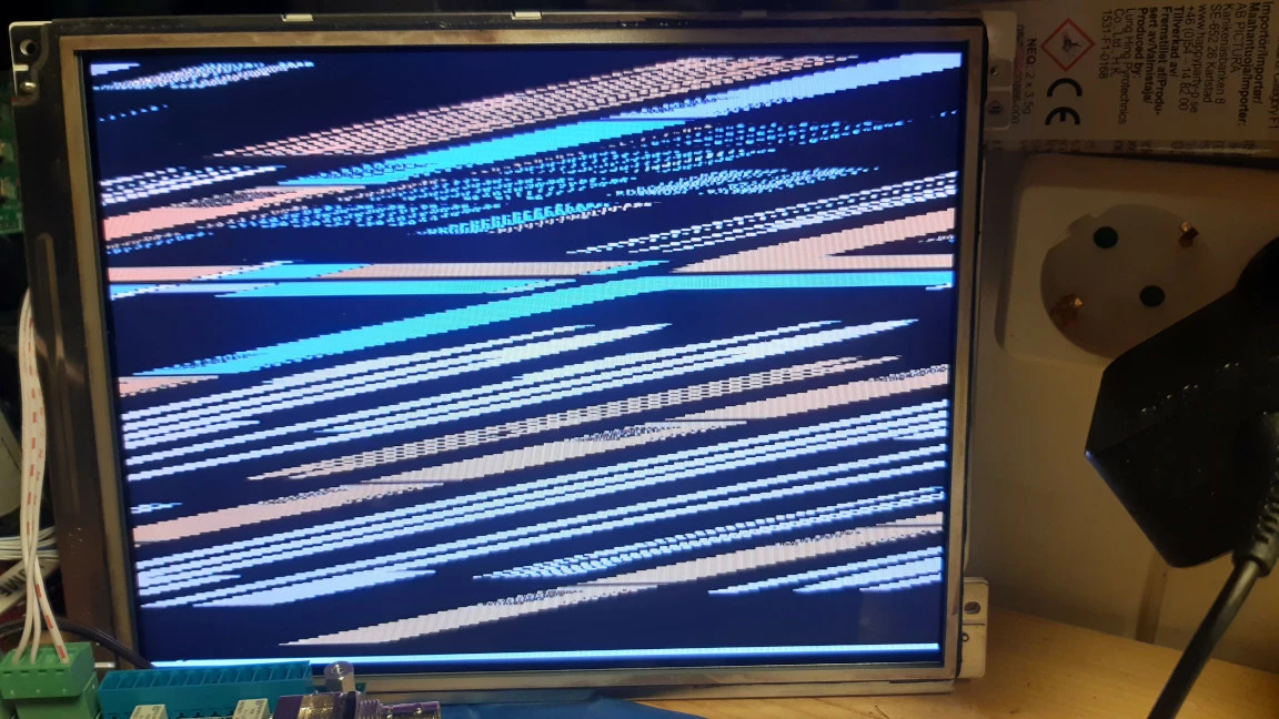

My TFT display looks ok, but after adding code to my project, not related to the display driver, the screen output is skeewed / Distorted. Need help thinking

Well, all that mentioned, Thing and problem is. Whit the paramtetres, and several other combinations, shown above, the screen shows up perfectly. I may write text, load images and etcetra. But Sometimes when I add extra code to my program the screen gets skeewed like as if the image was a water-painting someone tried to wipe out, or as if the number of pixel pr. line changed but the MCU still think it is 640 so that the next line has an offseth to previous line. You are able to see that it tries to show the correct image but it gets corrupted
The code added does not need to have anything to do with display functionality, for example I added a few variables and the problem arised. When I removed the code, the display was OK again.

I have some more information regarding the suspected memory issue.
The only change I do in the code is to add a variable or mor correct an array
static char States[25];
Thats the one change that is inserted. Did some experiments here, When the array size is 25 and above, the display is corrupted, 24 and below it is ok. The memory status window says that only 68% of the memory section D1 is used,. When compiling the States array is allocated before the Framebuffer1 thus moving it in memory. I have no clue for why that should affect the display but somehow it does. Display registers are setup correctly, PLLs are correct, the layer 1 frame address register has the correct address, and so on.

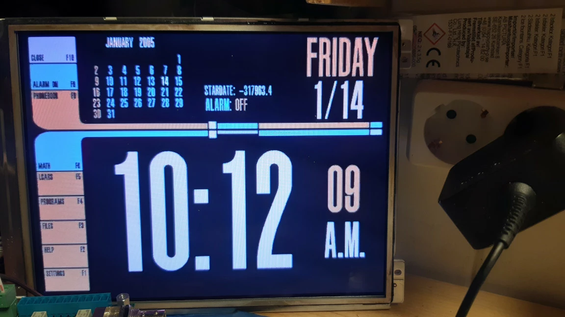

Here is the images showing corrupted and OK image
The only different is that the array size mentioned is 24 and not 25 for OK immage. Memory usage is 68%
EDIT:
Looking at the corrupted image you see that it is the same image as for the ok display. However, i noticed now that the 4 last lines are not part of the image. I guess this possibly indicates sync issue for when display expects first data and when the MCU transmits it.
You will see a similar behaviour if one deliberately program the frame start and stop addresses for layer 1 with wrong values (Either horizontal or line or both in register L1_WHPCR and L1_WVPCR), then you will also see this skew. But in the tests above these remains unchanged and should not be affected by the introduced code, and the clock/timing setup for LTDC is as mentioned earlier also unchanged.
I wonder if it could be sync issues with the enable signal but struggles to see how the code i insert (declaing the array) possible could affect this in any ways.

The code I run today is much like as you describes it, Its just the framebuffer filled with some known data. Its no problem with the CLUT either. The image in my example is an indexed image using the CLUT table loaded. I have of-course also tried with the buffer filled with a single value or a known pattern and this works without problems.

Thing is, as-mentioned initially the issues seemed to be related with where in memory the FrameBuffer is stored. Some further tests shows that the display is corrupted if address of FrameBuffer1[0] ends on hex 4 or C and so on, but works perfectly if stored on address ending on 0 or 8..... Could it be related with the ALIGN tag in the linker-script.? It is for RAM_D1 set to 4 so all variables are stored on a boundary of 4.

I know it sound silly but for each change in address by 0x4, the display switch between working and not working.
This also explains why Status[24] worked and Status[25] to Status[27] did not work, (these where the numbers I tried) since every increase or decrease by 4 in array size would change the FrameBuffer1 address by four.
However, WHY???? the LTDC does not work when the FrameBuffer1 is on the "Wrong" address is difficult to understand right know. I am sure there is an explanation somewhere. Something withe the ltdc register fetching data from memory which does not work well with memory alignment? (that thought was just a blind-shot), Or is it related to the fact that the AXI Bus is 64bit wide...??? Or the FiFo beeing 64bit wide

MM..1Best answer
October 26, 2020
Perfect you make own reply. I use in all projects framebuffer in SDRAM started on zero addr, then this issue dont see, but yes LTDC have limitation for place start . Then use __attribute__((aligned (8)))
For details read https://www.st.com/resource/en/application_note/dm00287603-lcdtft-display-controller-ltdc-on-stm32-mcus-stmicroelectronics.pdf
