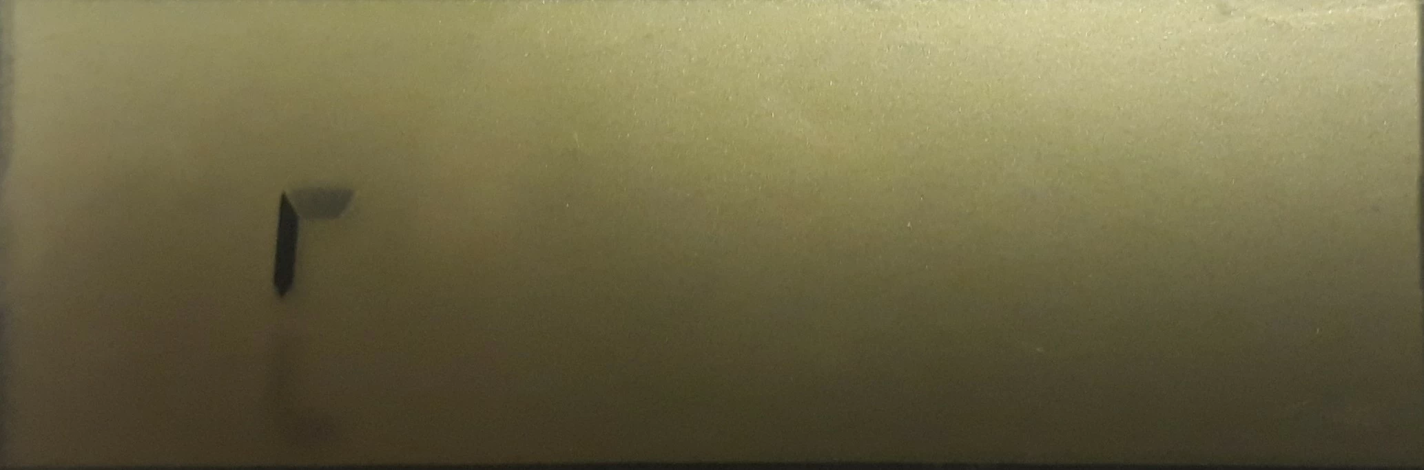

I have a custom lcd to drive with STM32L073VBTx's internal lcd driver. Duty cyle is 1/4 and the bias is 1/3. The problem is the common pins are activated sequentially even the LCD's RAM registers are equal to 0. When I activate some bits in LCD's RAM register, these segments have more contrast. I changed and tried to all possible configurations of duty cycle, bias, high drive, dead time duration etc. but the result was same. Do you have any idea about this problem?

waclawek.jan
May 12, 2022 1:12 PM UTC
What do you mean by this?
Waveform on COM outputs is always the same, regardless of RAM content. It's the SEG outputs on which the waveform changes with changing RAM.

0693W00000NprvOQAR.jpgI should give an example to my problem. I've set just LCD->RAM[0]-> |= (1UL << 14) and other bits of RAM[0] and other LCD->RAM registers are 0. But I see the all 14th segment(SEG14) controlled by all 4 common pins in screen. The segment that COM0 controlled is more visible than the others. I uploaded an image here to make more understandable of problem.
Best Regards.

It's a good explanation of multiplexed driving. As far as I understand, the COM signals are activated sequentially. In my problem I cleared all RAM registers of internal LCD driver, but I saw the segments weakly in LCD's screen. When I slow down the frequency of the LCD's screen, the COM signals sequence is quite visible. So can I say that if the LCD driver's RAM registers are equal to 0 that means I should not see any segment in screen?

waclawek.jan
May 13, 2022 7:37 AM UTC
To me, this looks like insufficient "drive", i.e. the intermediate voltage levels not holding their values properly. Read carefully the Voltage generator and contrast control subchapter of LCD chapter, and try to experiment with parameters listed there. If you generate the voltages using an external divider ladder, you may consider changing the resistor values there.
You should also have a look at the waveforms using oscilloscope and check/compare the COM1-COM3 and SEG14 levels.
