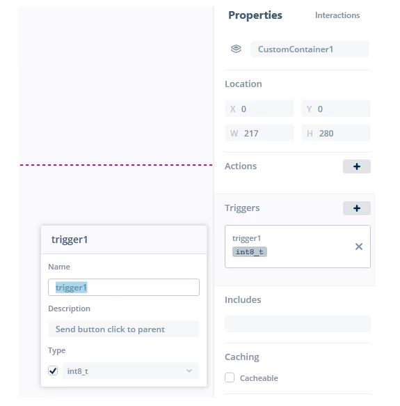

I have been struggling to get my head around the way custom container call backs work.
I have a custom container that has three flex buttons, this container is then used on a single screenview multiple times.
I'd like to be able to identify the flex button pushed along with knowing what custom container this came from. Sounded simple and i am sure it is, my head is just failing to get around the multiple files that this process spreads across.
Best answer by justin11
Great thanks, ill give the 2nd one a go :thumbs_up:
5 replies
Graduate II
May 22, 2024
Hello Justin
Easiest way (?) to make this is use Triggers in custom container and actions in view. Then you dont have to play manually with callbacks.

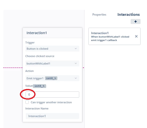

First create trigger to your CustomContainer:
The variable is used for sending the clicked button index.
And then add interaction like this to all three button:
Set value for example 0 - 2 (red circle) for buttons as index.

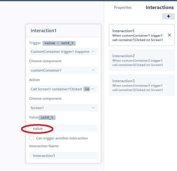

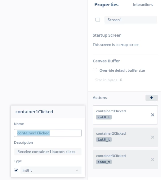

Then in the view, add three action for receiving the callbacks.
Then add three interactions like this
Remember to write red circled 'value' !

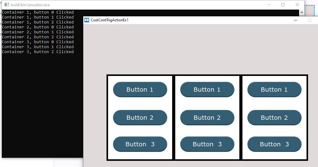

Then implement container1/2/3Clicked functions for actions, you can copy prototypes from viewBase.hpp file (if you generate the code after adding actions).
Like this in view.cpp

Then it works like this

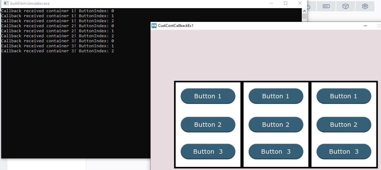

Graduate II
May 22, 2024

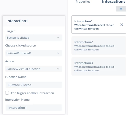

Or like this...manually:
Just set the button interactions to call virtual functions Button1/2/3Clicked at customContainer.

Does pretty much the same...:
