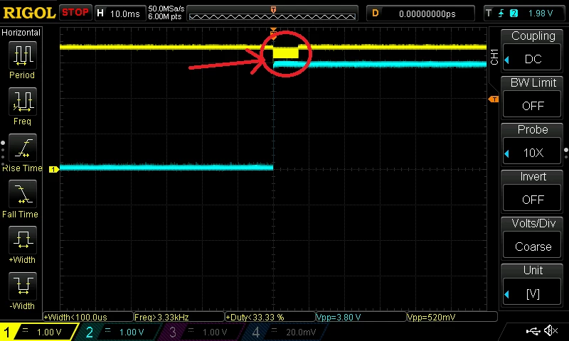

Here's the waveform captured on an oscilloscope.
0693W00000DqVEZQA3.pngHere the yellow waveform is the analog signal to the ADCs,
The cyan waveform is the GPIO PE4 which I used in the code above in order to find out when the ADC starts.
As you can see in the marked area in the picture, the ADC sampling starts as soon as the PE4 gets high, but instead of running until the PE4 gets low which is when the ADC suspension should occur, they just turn off after ~7ms.

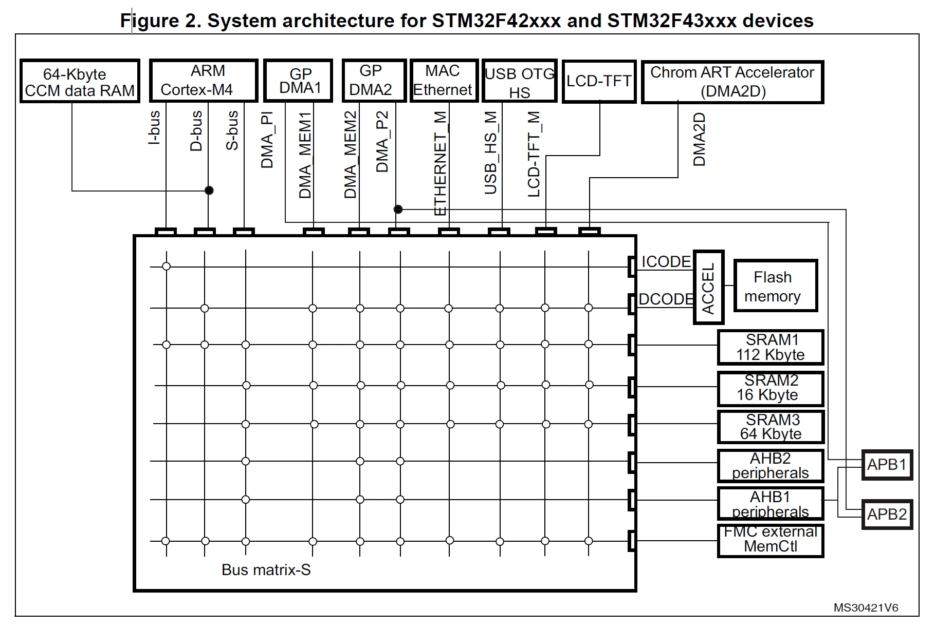

HAL_ADC_GetError just returns ErrorCode from within the handle. That's only populated by HAL if you're using its framework for handling errors.
I would examine the registers directly for an error. Although, clearly bandwidth is the issue here so I'm not sure how useful that would be.
DMA doesn't use the CPU, but it does use the system bus, along with pretty much everything else that needs to access memory. The bus is a shared resource. When it's occupied, the CPU will block until it gets what it needs. Since the ADC/DMA can't block, it overruns and will set an error flag. See the "System architecture" figure in the reference manual for a conceptual view of this.

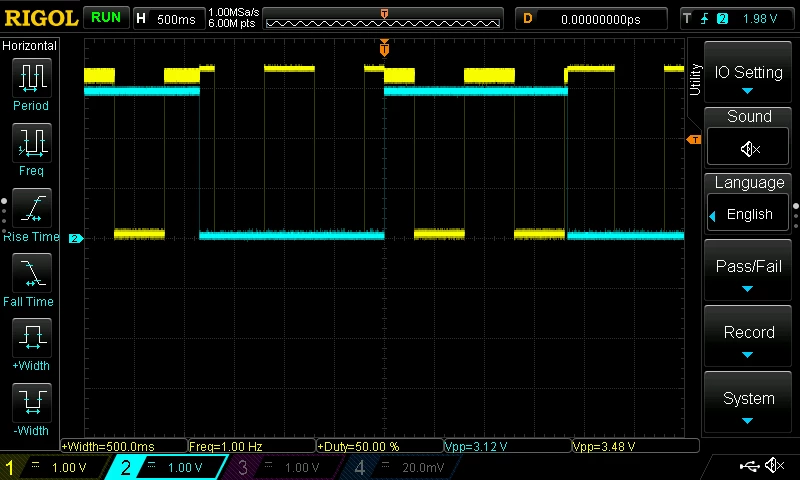

And here's the result:
0693W00000DlVX7QAN.pngSo as you can see, now the ADCs are running for 500ms, and are suspended for another 500ms.
While the ADCs are running, the screen & touchscreen are basically frozen, and while the ADCs are stopped, the LCD&touch are completely responsive.
