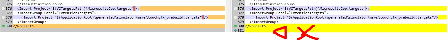

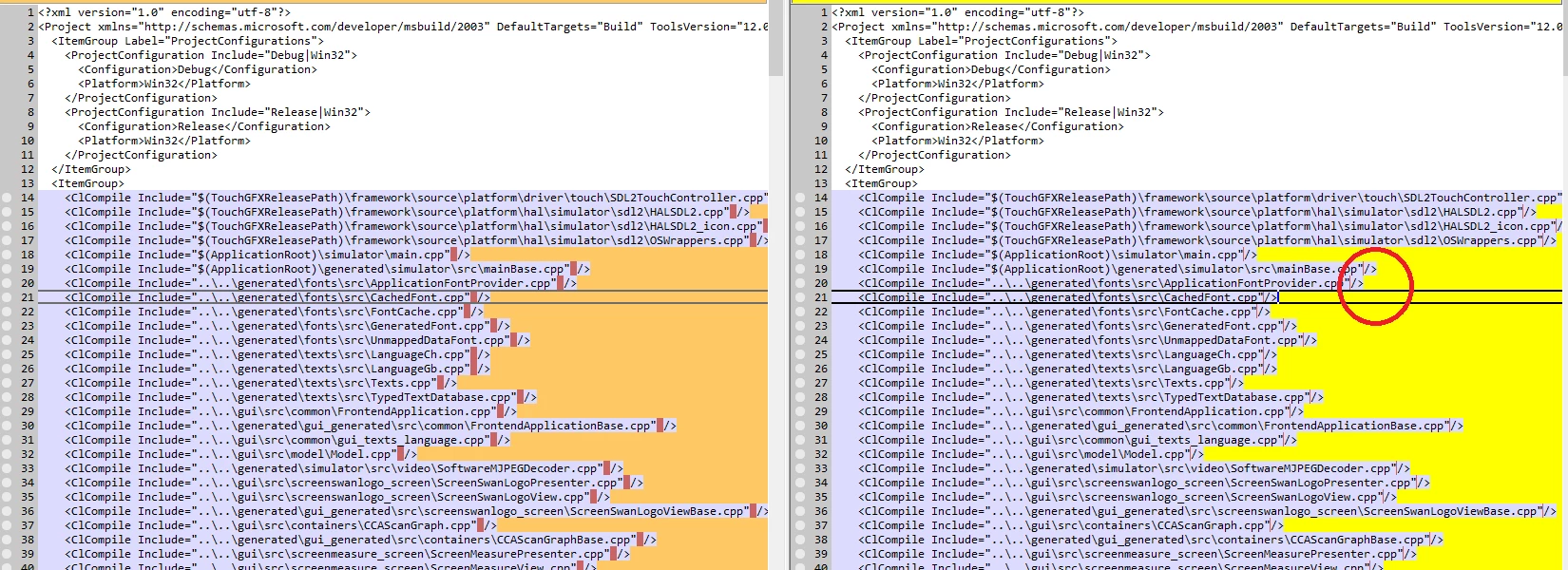

When I open MSVC file generated by GFX Designer in MSVC IDE and save it without any change, it is different from what GFX Designer generated. While it is just a space which is missing, the file is flagged by eg versioning tool.
Could you possibly add that extra space between quotation mark and forward slash at the end of self-closing tag please ?
And 2nd difference is an extra new/empty line at the end of the MSVC file

    I think this is caused by changes in how MSVC IDE generated/stores its project files.
    First I delete all files autogenerated by GFXDesigner:
    Application.vcxproj.filters
    Application.sln
    Application.vcxproj
    Then I generate them again.

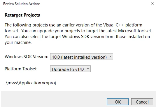

    When I open the Application.sln, my MSVC IDE asks me to convert project files to my version of tools (Version 16.11.27)
    After pressing OK the spaces are added to Application.vcxproj as I showed in my initial post.
