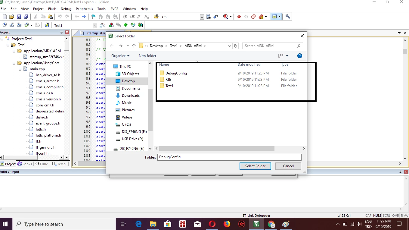

https://touchgfx.zendesk.com/hc/en-us/articles/360020001992-Configuring-STM32F7508-DISCOit is only described by ewarm program but there is no information about keil related library installation under this title

how to install touchgfx touch libraries keil
Do you have a description of this issue

For keil you simply add the library to the project like you would a source file.
