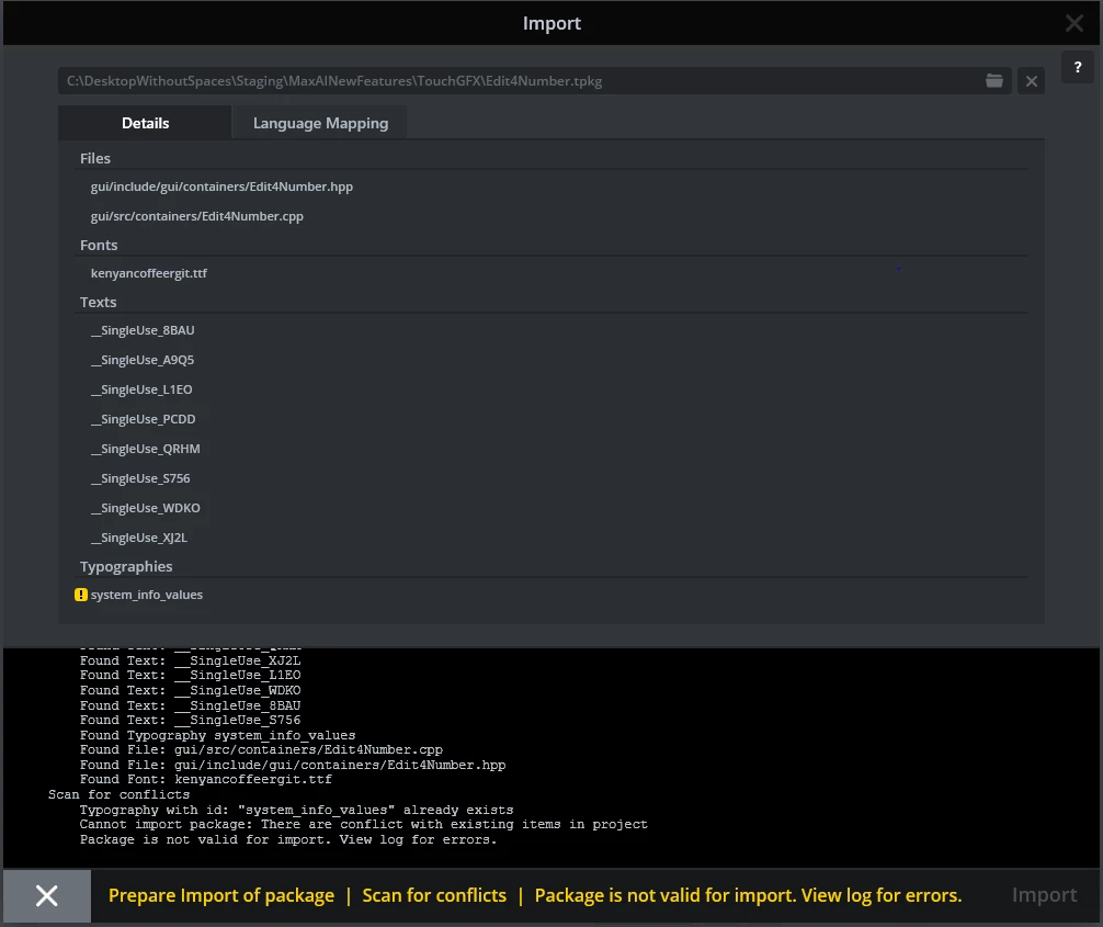

Migration from 4.18 to 4.20 Problem with the autogenerated class Edit4Number files
When moving the application across touchgfx versions, I am seeing unresolved dependencies for the aforementioned class. Is there any documented solution to this class and its base class?

0693W00000aHx8gQAC.pngThis I am getting when I am exporting custom containers in version 4.20
And I am getting for 4 other containers

I want to move the containers named
Edit4Numbers
Banner Container
DPF_Digital
AlarmsContainer
MessagePopup
From this to the project pasted above

It seems that you have this typography 'system_info_values' allready in the project you are importing to. This import containers- function cannot handle same typography name in the widget you are importing and orignal project (at least in the latest version it dont work, there comes this conflict).
I guess only way is to rename typography 'system_info_values' to for example 'system_info_values2'. Then after importing you can set all necessary reources to use 'system_info_values' and remove 'system_info_values2' typography.

This typography needs to be edited via the touchgfx software or manually I am not getting the idea ....

In tgfx designer - Texts - Typographies change the names for typographies which are same in original and imported project.

Indeed, your containers seems to use the same typography names as your project's and it causes the conflict. Renaming it as JTP suggested is a good idea, did you tried it ?
