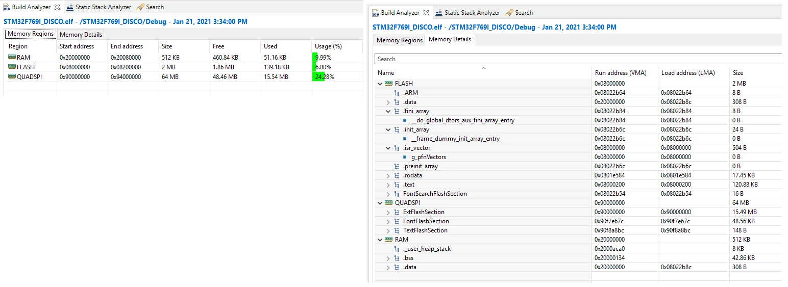

I am looking to perform a similar resource usage as explained here https://support.touchgfx.com/docs/basic-concepts/memory-usage/
However, I am wondering if there is a guide that is available using freely available tools to do
the memory analysis on the deployed code.
My environment is TouchGFX-Designer-4.16.0 and I am able to generate & deploy code to
an STM32F769I-DISCO board. I don't have dedicated IDEs installed yet.
I found C:/TouchGFXProjects/MyProjectName/gcc/Makefile
and I see the lines linker_options that eventually leads me to
TouchGFX\build\bin\application.map - Is this the correct file?
Its contents is not summarized as shown in the examples, so I am wondering if
 there are post processing steps that can be done to that file.
Or is there a better option?
Is the expectation to be able to just open the .cproject file in STM32CubeIDE and do a build?
An updated guide on the analysis based on STM32CubeIDE or VisualStudioCode maybe more accessible for more people that are just getting started.
Thanks for everyone's time!
Best answer by N. SANTINI
This is indeed the map file generated when building from the Designer, using a Makefile-gcc toolchain, unfortunately ST does no provide some easy ways to analyze this file which can be quite huge.
However if you install STM32CubeIDE and open the .cproject you will be able to build, flash and debug your application without further effort as it is the default IDE.
Moreover STM32CubeIDE provides some high level memory usage view, once your project is built through the "Build Analyzer" window, and in the same window but in the "Memory Details" tab you get a deeper view, region per region (as defined in the .ld scatter file) :
I hope this will help,
Best regards,
Nicolas
Best regards,
Nicolas
