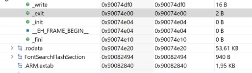

0693W00000NqrlQQAR.pngI take a look into "Build-Analyzer" ( in STM32CubeIde ) and see in the FLASH section .text following entry:

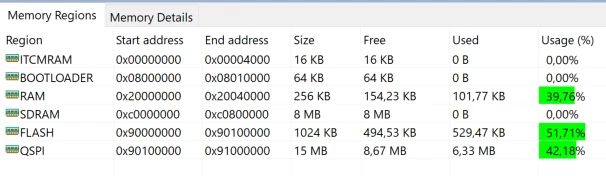

0693W00000Nqrm9QAB.pngMemmory Regions is attached to get an overview:
0693W00000NqrmJQAR.pngI don't know what I could do anymore. If there is a problem of linker script?
Have anyone an Idea or can help me to figured out the problem?

There typically isn't source code for library code, it's just a collection of objects.
The exit() function is likely an infinite loop.
Perhaps review why any of your code is calling exit(), likely a cop-out exit/failure path.

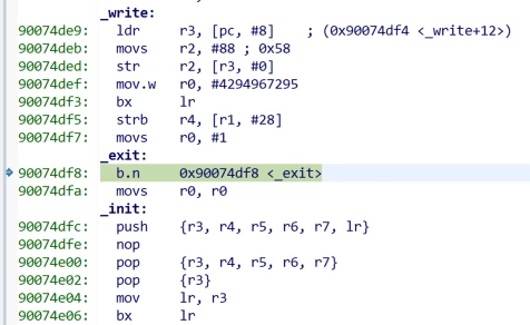

I have add actions, triggers and interaction functions to fill-out with code in CubeIde.
My Programm includes 4 Task ( RTOS ) and they are only have an infinite loop, but it's just normal.
My Disassembly while debugging shows me the infinite-loop pattern:
0693W00000NqryFQAR.pngWhat means instrcution b.n?
