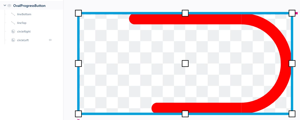

May I ask, is there any design clue for this oval loading
Excuse me, how can I implement this kind of loading
I'm really at a loss for ideas. Please help me out, thank you

Hello @DreamLovely.
You can quite easily create a custom widget for this by using two Circle widgets and two Line widgets, as illustrated below:
Let me know if that makes sense. Otherwise I can create a small example.
