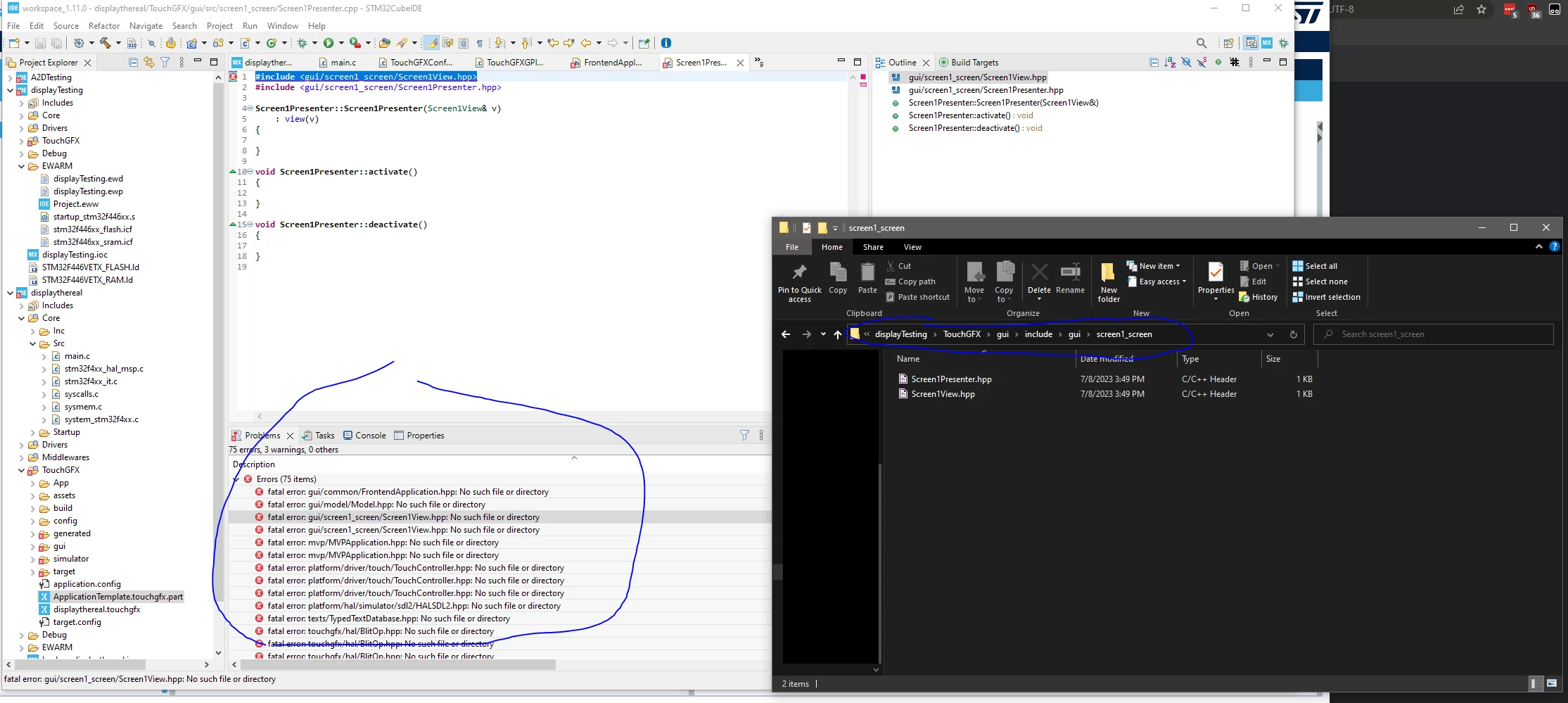

I spoke too soon
I've found that whether I set the targeted language as C or C++ didn't actually make a difference. If I try to compile the project before making any changes to the TouchGFX settings, like changing the resolution or frame buffer strategy, then go into touchGFX and generate the code it will compile, but as soon as I make any single change it will no longer compile even if I change the settings back. This also appears to be true if I manually make a change to one of the offended .cpp or .hpp files.

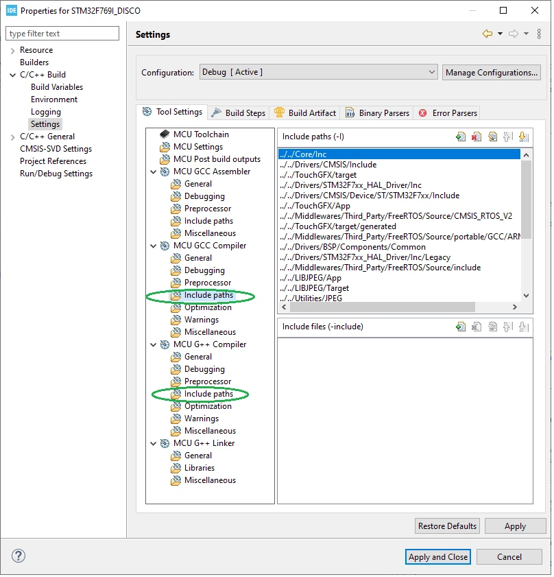

I had not yet read those.
I disabled Generate Under Root as per the first guide
I verified all necessary Include Paths were present for both the MCU GCC and G++ compiler's, except for /TouchGFX/platform/os as that directory is nowhere to be found.
I verified all the necessary compiler switches are present for the GCC compiler, but not the G++ compiler. I attempted to add them into the GCC compiler under  Miscellaneous -> Other Flags and that made no changes.
The core library path is present in the linker options. However, many of the suggested options were missing. I attempted to add them in under MCU G++ Linker -> Miscellaneous -> other flags and that made no changes.

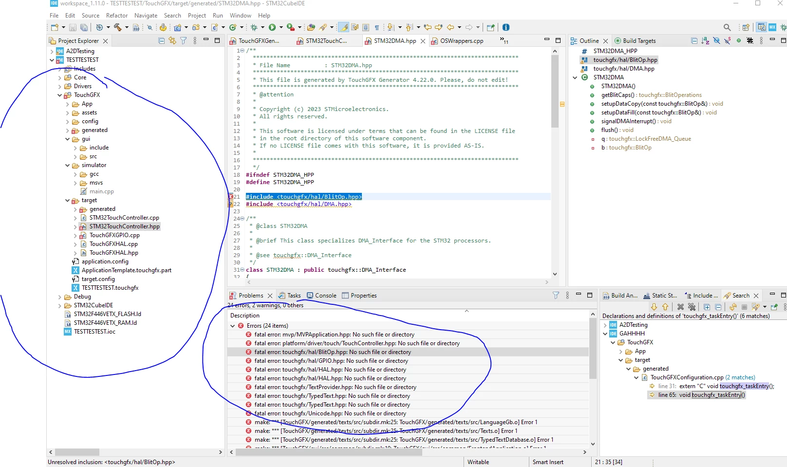

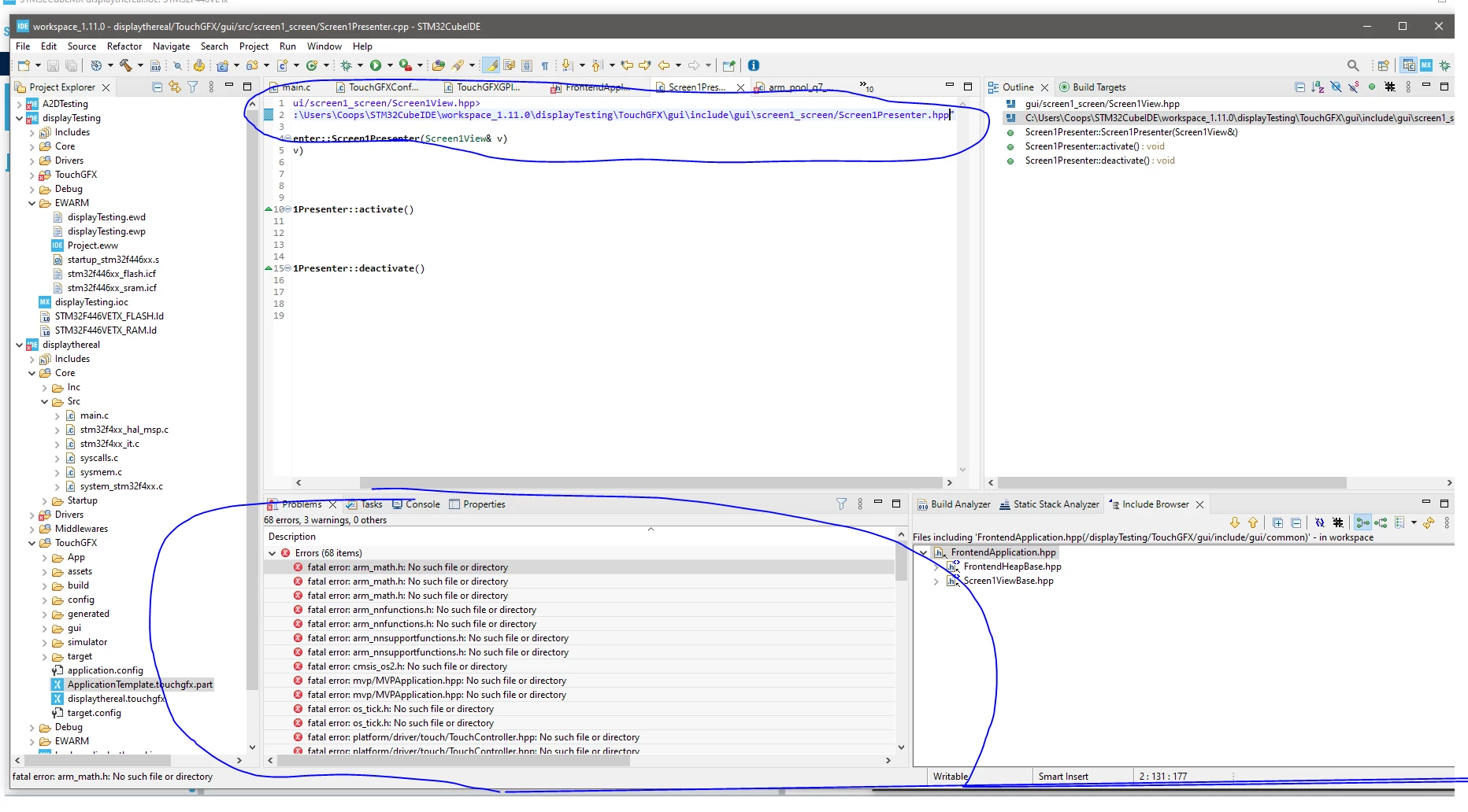

I'm having the same problem. Sequence of events:
  • Create a cubemx project
  • generate code within cubemx
  • open the .part file in touchGFX designer
  • make a simple UI
  • generate code within touchGFX designer
  •  hit compile within stm32cubeide
  • Get numerous "No such file or directory" errors. The files all exist and can be found using windows search.
  • Start playing wack-a-mole, adding include directories to the project. This eliminates some of the errors but not all
  • Notice that not all the include directories are shown in the compilation command preceding the error.
