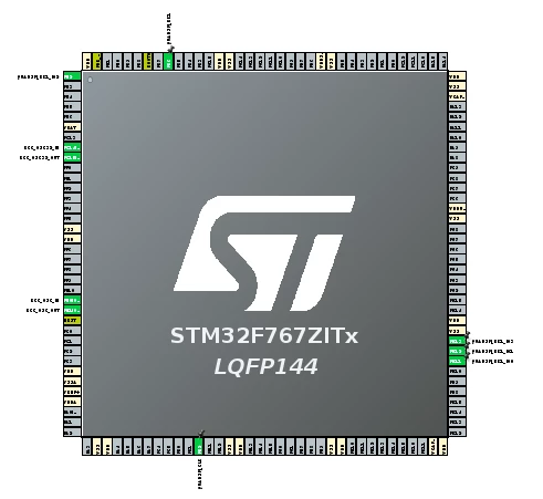

I'm integrating a custom QSPI display controller with TouchGFX and ThreadX. I need to convert the TouchGFX framebuffer into RGB666 (6 bits per color) for a custom display interface that runs over SPI/QSPI.
Here is my IOC. As you can see, I currently have only the QSPI and the clock connected.
I believe the framebuffer is defined in TouchGFXGeneratedHAL.cpp as:
LOCATION_PRAGMA_NOLOAD("TouchGFX_Framebuffer")uint32_t frameBuf[(320 * 240 * 2 + 3) / 4 * 2] LOCATION_ATTRIBUTE_NOLOAD("TouchGFX_Framebuffer")
My target app currently runs on an STM32F7. I also have a GFX01M2 display on a Nucleo H503, but the SPI display example is of limited use because it appears to use many more GPIOs than I have available in my application (I only have QSPI).

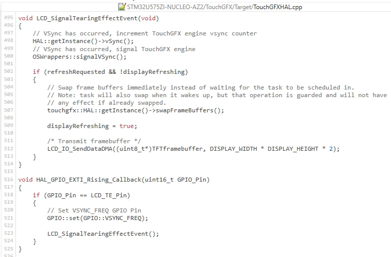

But if you need to do this manual color conversion etc., I will recommend you to look at our "NUCLEO-U575ZI + GFX02Z1" application template available in TouchGFX Designer. This uses double framebuffer and FMC 8-bit interface to transfer the pixels, which is very similar to QSPI. Here the framebuffer swap is synchronized with the Tearing Effect signal from the display:
I think you could use the same synchronizing mechanisms and then you just need to make your own implementation of the LCD_IOSendDataDMA function, which fits your display interface.

Ok. If you do not have any tearing effect signal available, you will probably risk some display tearing since your 60 Hz is not synchronized with the actual refresh of the LCD. But you can still use the logic that is implemented in the LCD_SignalTearingEffectEvent function in the code snippet in my first message. You just execute it in your timer event instead of an external interrupt event.
The logic implemented in this example (line 502-513) uses the swapFramebuffers instead of lock/unlock. After calling this (if needed), the pixel data to be transmitted can be access directly using the TFTframebuffer point like shown in line 512.
