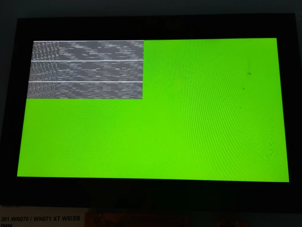

Mar 7, 2023 7:56 AM UTC
It's a custom board, see current display:
(layerCfg.WindowsX1 / Y1 set to 480 / 272 and layerCfg.Backcolor.Green = 255;)

Mar 8, 2023 6:59 AM UTC
See attachment. I managed to convert a bmp-picture to ARGB888.
But the ARGB888 480x272 picture array, even with "LTDC_PIXEL_FORMAT_ARGB8888" the picture is not displayed correctly. I see only several lines in different colors...
What do I miss?
