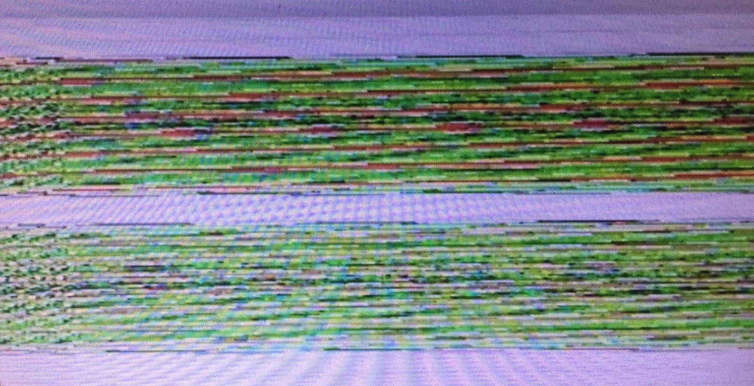

Hello everyone.
I have a question. I am using the stm32h723 processor in a project. I keep my image data in octoSPI external ram correctly. When I show OCTOSPI_BASE_ADRES to LTDC peripheral, the screen is distorted, but when I keep the same image in my flash memory, the image is fine. What would be the reason?.Could it be a sync problem between ltdc and octospi?

First point would be to identify the problem. LTDC has status flags (transfer error, underrun), ever checked?
As already mentioned bandwith and latency could be issues: Faster RAM, faster clock for OctoSPI, quad mode, dual quad mode?! Some flash chips have a so-called XIP mode, this would decrease latency, but don't know whether your (secret?) RAM does support it.

Liitle math example about bandwidth, what is your primary issue.
You setup LTDC to show RGB888 from base addr octo SPI. Setup LTDC clock 50MHz.
RGB888 is 3 byte format then your bus OSPI need work on minim 150MHz ...

I'm running LTDC at 30Mhz and using the RGB565 format. OCTOSPI works at 120Mhz. It's not clear in the picture. Could it be synchronization disorder or latecy at these frequencies. I am sending the image
Andreas Bolsch
Lead III
Dec 6, 2022 8:18 AM UTC
Again, did you check LTDC status flags?
I'd suggest to copy (largest possible part of) the image from the external RAM to the internal static RAM using very same start address, precisely the same (memory mapped?!) mode via DMA burst transfers and verify that contents in external RAM is correct. DMA burst closely resembles the way LTDC accesses display memory.
