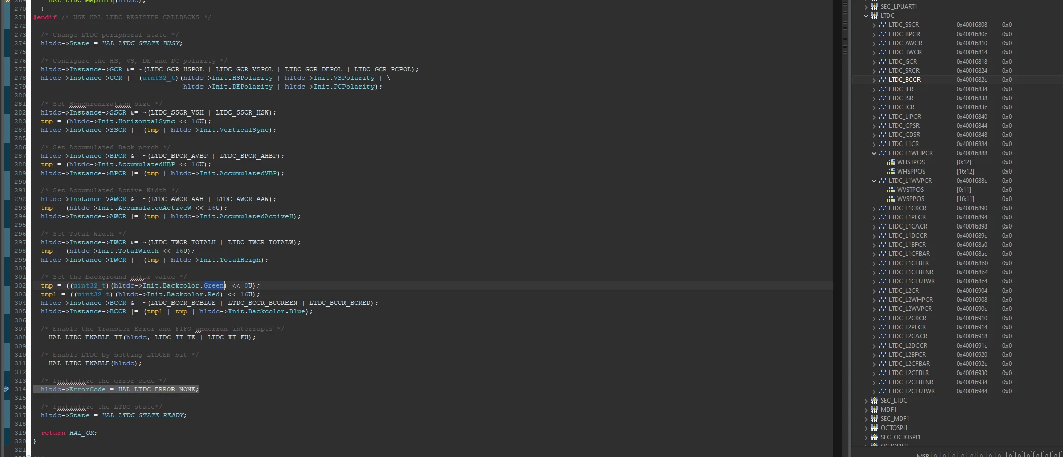

I observed the registers as i stepped through the HAL_LTDC_Init() and none of the LTDC registers are being updated, so LTDC is never setup nor enabled as they aren't being written to... what could cause this?
The init vars do have the cubemx values in them

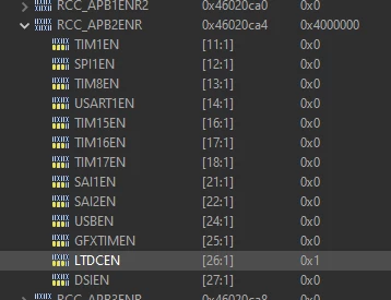

Make sure the LTDC clock is explicitly enabled in the RCC
LTDCEN in RCC_APB2ENR
PhilipCAuthor
Jan 19, 2024 9:21 PM UTC
Yes, this is set.

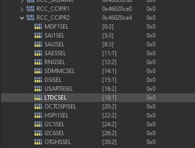

Jan 20, 2024 11:02 AM UTC
I tried the following and LTDC register will not accept anything.
LTDCRST = 0
LTDCEN = 1
 while (1)
 /* USER CODE END WHILE */
	 temp = LTDC->GCR;
	 LTDC->GCR = 1;
 /* USER CODE BEGIN 3 */
 /* USER CODE END 3 */
Could it be something with my clock setup?
I added an I2C peripherial and after MX_I2C1_Init() i can see values in the I2C registers, but nothing for LTDC...

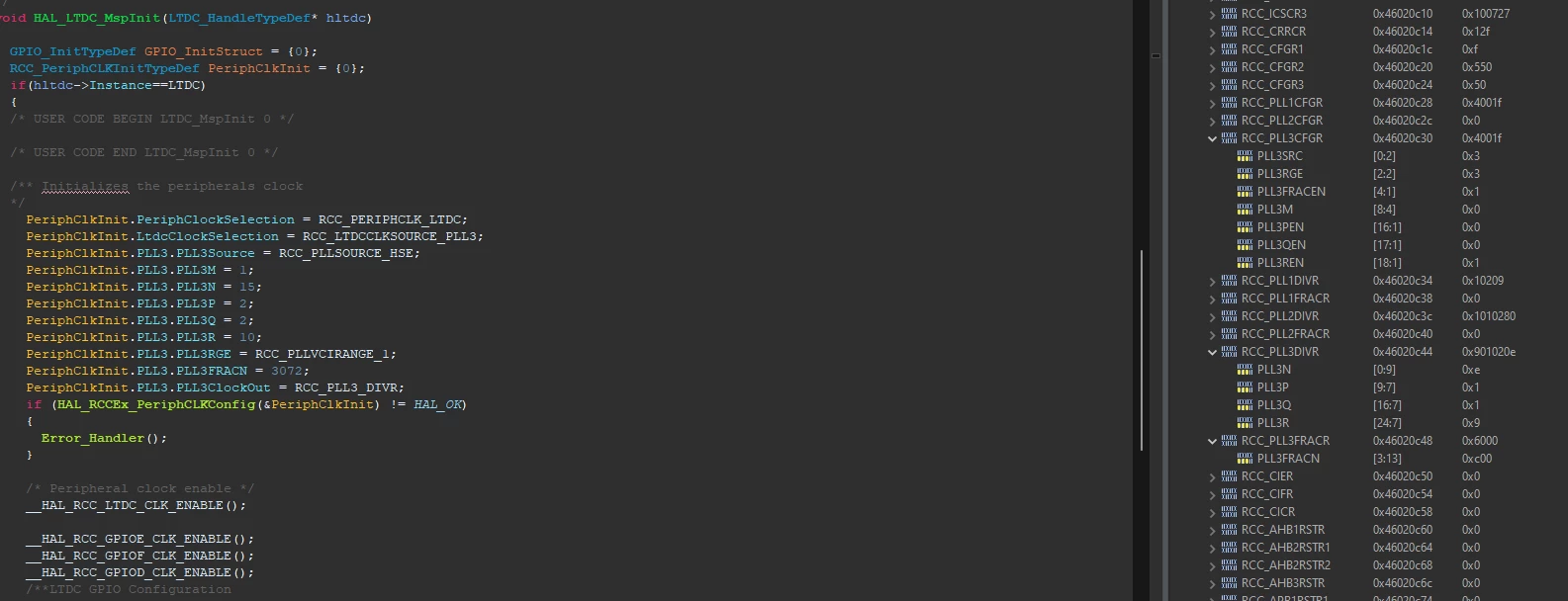

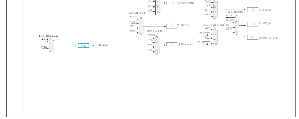

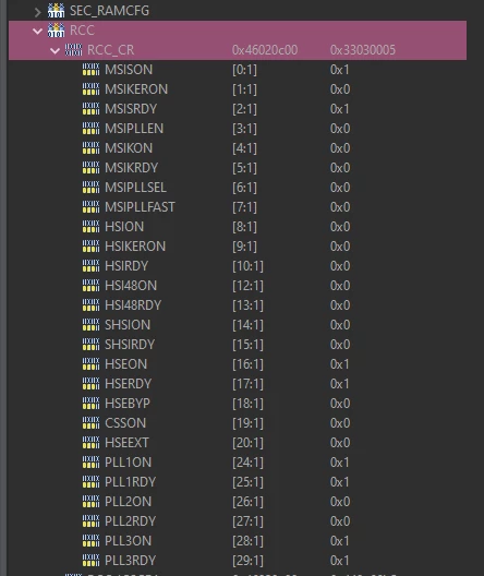

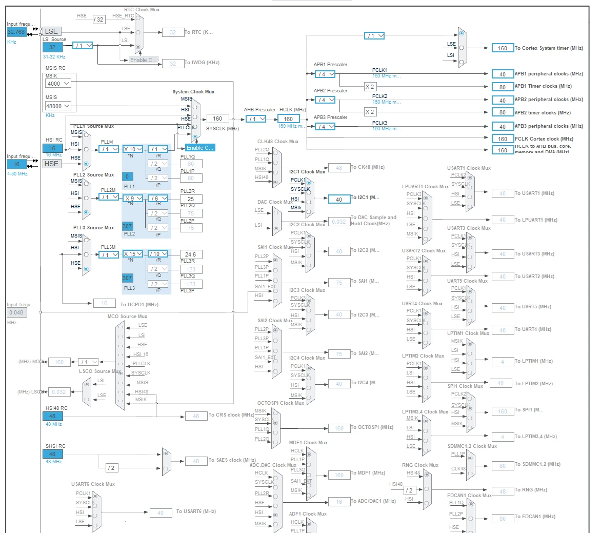

waclawek.jan
Jan 20, 2024 8:35 PM UTC

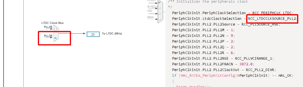

So, which one is it, PLL2 or PLL3?
Read out and check/post relevant RCC registers content.
PhilipCAuthor
Jan 20, 2024 8:45 PM UTC
Ah sorry I flipped to PLL3 when experimenting stuff, the code does now also point to PLL3.
Does this look like the PLL3 registers aren't reflecting what the code says?
void HAL_LTDC_MspInit(LTDC_HandleTypeDef* hltdc)
 RCC_PeriphCLKInitTypeDef PeriphClkInit = {0};
 if(hltdc->Instance==LTDC)
 /* USER CODE BEGIN LTDC_MspInit 0 */
 /* USER CODE END LTDC_MspInit 0 */
 /** Initializes the peripherals clock
 PeriphClkInit.PeriphClockSelection = RCC_PERIPHCLK_LTDC;
 PeriphClkInit.LtdcClockSelection = RCC_LTDCCLKSOURCE_PLL3;
 PeriphClkInit.PLL3.PLL3Source = RCC_PLLSOURCE_HSE;
 PeriphClkInit.PLL3.PLL3M = 1;
 PeriphClkInit.PLL3.PLL3N = 15;
 PeriphClkInit.PLL3.PLL3P = 2;
 PeriphClkInit.PLL3.PLL3Q = 2;
 PeriphClkInit.PLL3.PLL3R = 10;
 PeriphClkInit.PLL3.PLL3RGE = RCC_PLLVCIRANGE_1;
 PeriphClkInit.PLL3.PLL3FRACN = 3072;
 PeriphClkInit.PLL3.PLL3ClockOut = RCC_PLL3_DIVR;
 if (HAL_RCCEx_PeriphCLKConfig(&PeriphClkInit) != HAL_OK)
 Error_Handler();

PhilipCAuthor
Jan 20, 2024 10:18 PM UTC

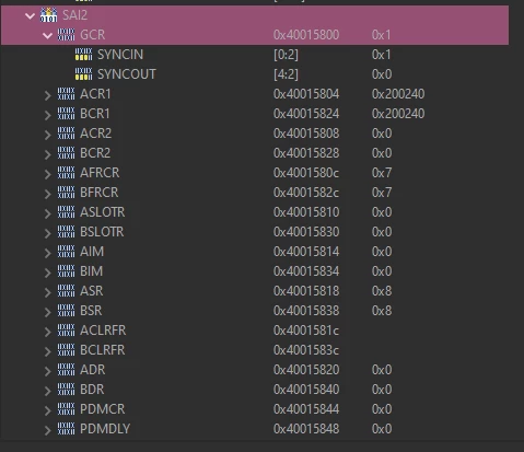

I just tried SAI2 peripheral as it is also on APB2, and it can write to its config registers fine.
I can also write to them and read them fine, so something specific to LTDC.
All the documentation I can find just points to LTDCEN being enabled before writing and nothing else, I'm really at a loss here.
SAI2->GCR = 1;

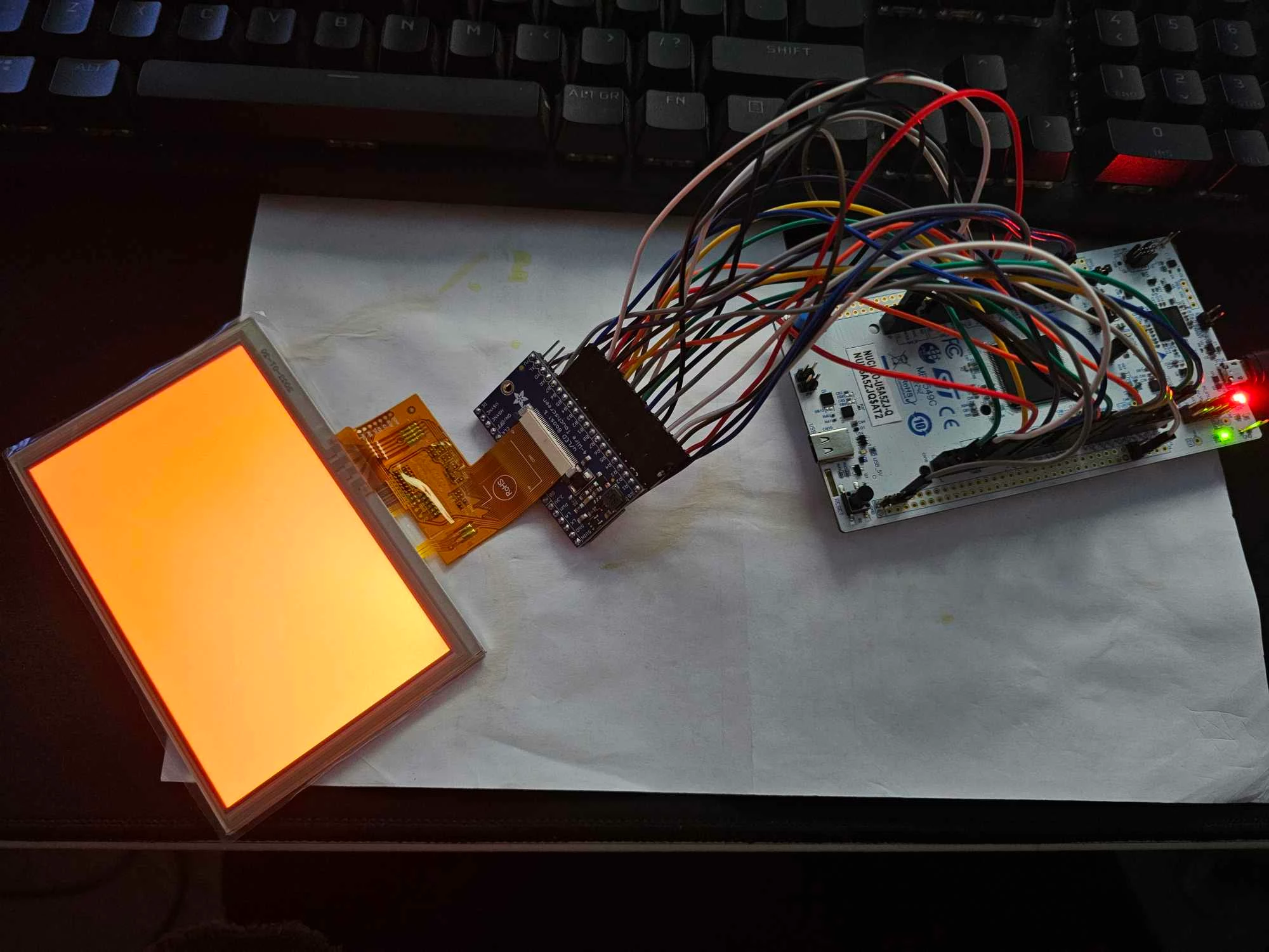

PhilipCAuthor
Jan 21, 2024 12:23 AM UTC
So I went to take a photo and couldn't believe my eyes...
I must have got the chips swapped at somepoint after removing the A5.
I have now swapped the A9 on and sure enough getting all the registers and a LTDC_CLK.
Thank you for your input and sorry for the confusion.
The display is now cycling through Black, White, Red, Green, Blue even though I have an empty while(1) but atleast it's a new problem.
I feel like a *** bashing my head against a wall for the past week only to find out I took the A5 off and put it back on... Thank you for you time @Tesla DeLorean
