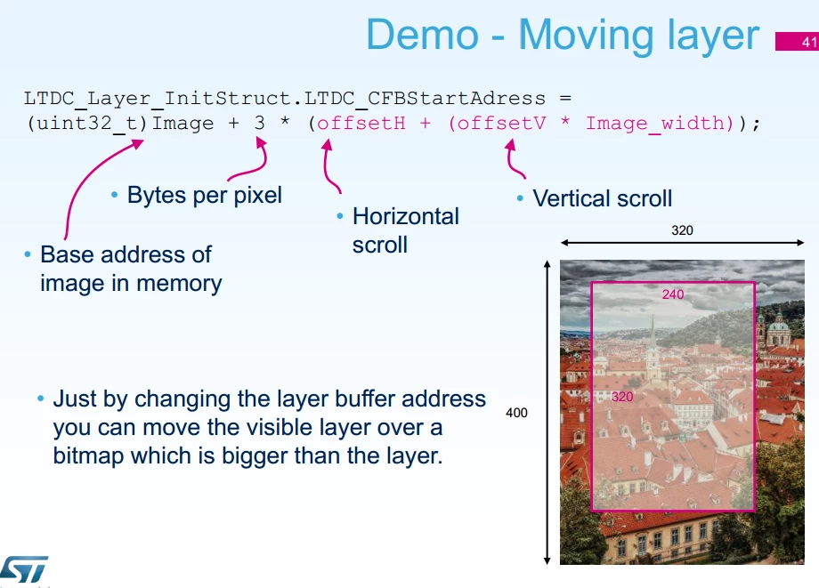

Hello!
I'm trying to use the peripheral LTDC to move the layer.
I'm loading an image 1024x768 at address 0xD0000000 SDRAM.
I need to move the display layer that has the resolution of 240x320, it is necessary to make a scroll effect .... however, I am unable to do this effect ... the examples of cube repository only show how to move a small image on a screen with higher resolution and I need to do the exact opposite ...
I tried to follow the tip of the slides 38 and 41 of a presentation of the ST, I found the link:
http://www.compel.ru/wordpress/wp-content/uploads/2013/11/1_LTDC_ChromeART.pdf
Please look at the attachment!
Please, I need a lot of it ... I'm desperate ... I'm trying to do this for several days and I'm not getting ....
Please help me!!!!
I am using the ''HAL'' library STM32Cube in KIT STM32F429-DISCO.
