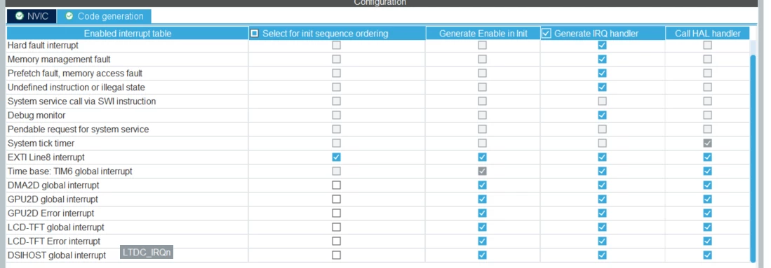

Hello @Anassoumi ,
The code you have shared looks correct. Is it possible for you to share a screenshot of the NVIC settings from your STM32CubeMX project?
Thank you

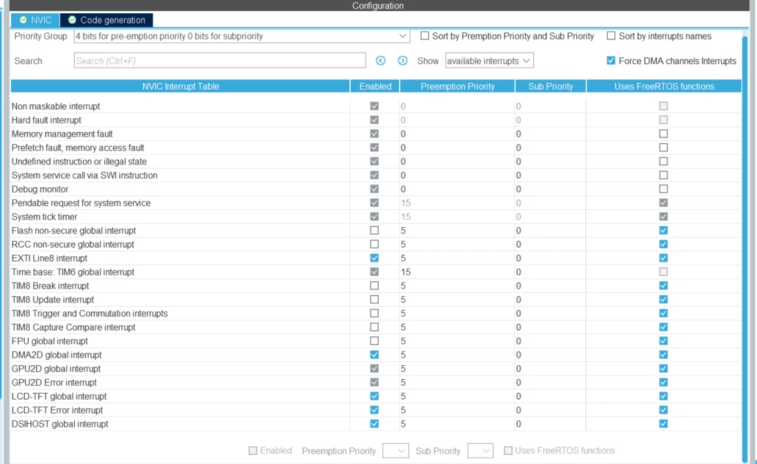

Thannks for your reply @Mohammad MORADI ESFAHANIASL , please see attached :
February 16, 2024
Thank you for the attachments.
I can see that you have set the TIM6 interrupt priority pretty low which might be the cause of the problem. Please set the priority of it to something lower than the rest (like 4), and set the priority of EXTI Line8 to something higher (like 10).
Try that and give us the results.
Good luck
