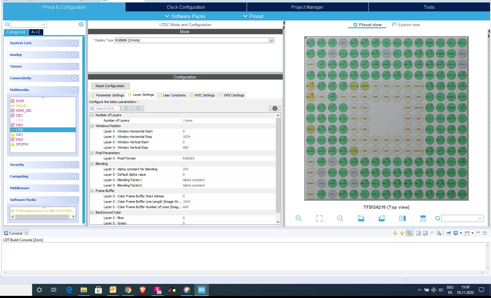

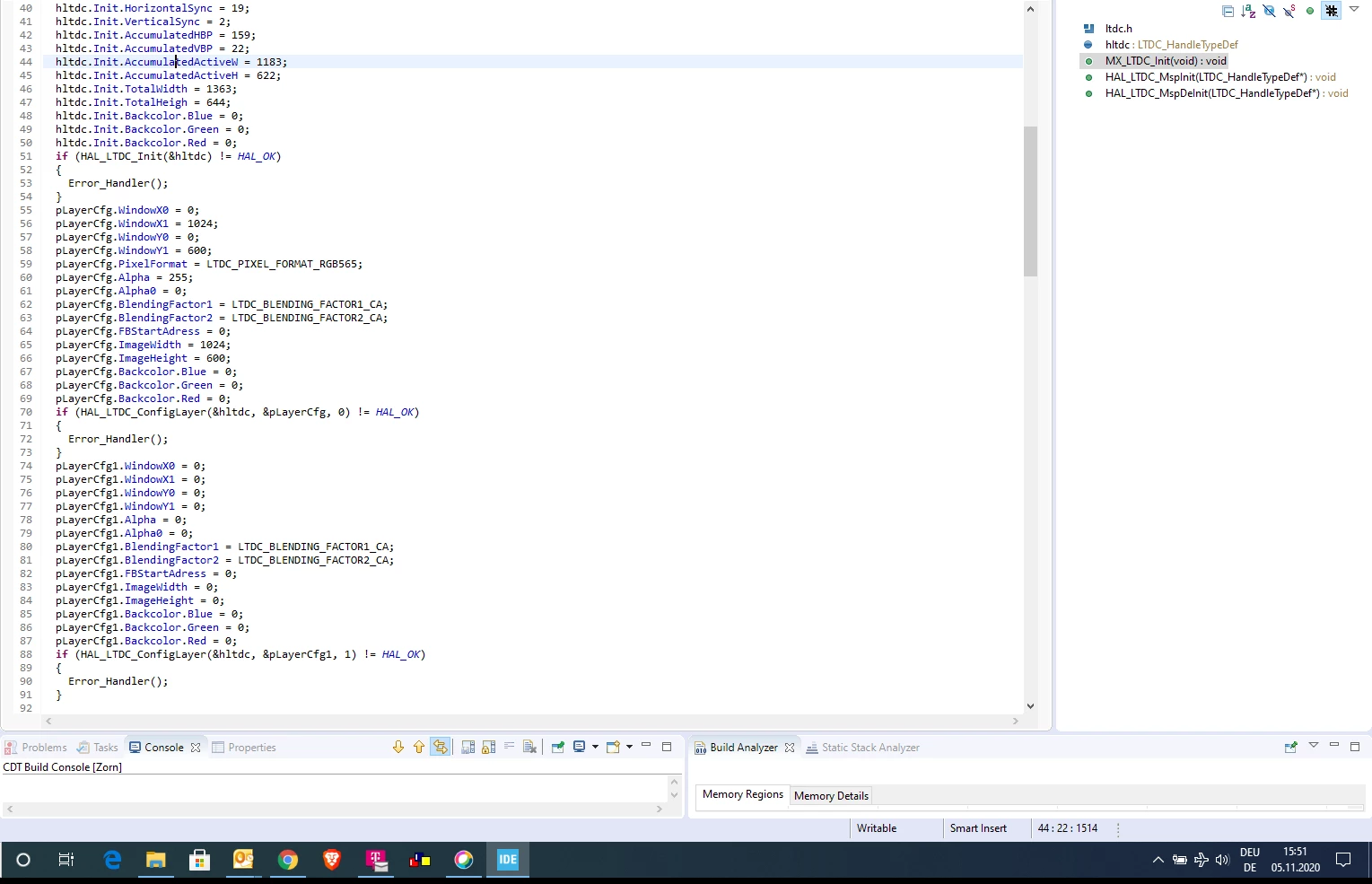

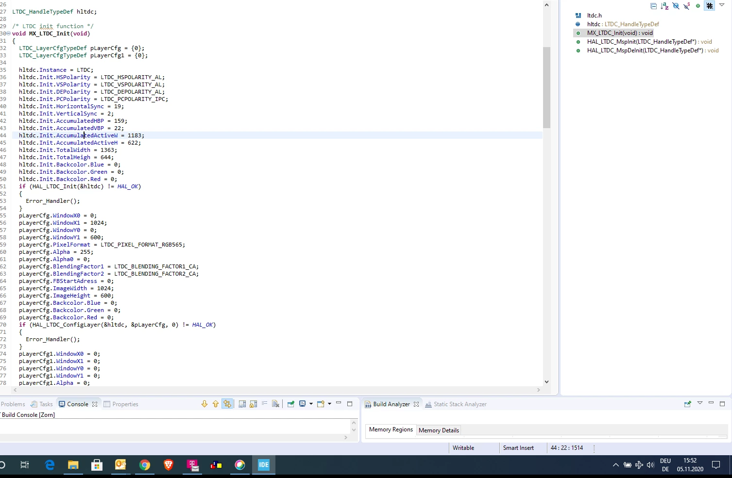

LTDC generation code issue
some thing is strange with the cube ide in the display controller LTDC initialization . i choose 1 layer only but the cube ide generate code for 2 layers!!
First time to see such thing

Khouloud ZEMMELI
November 5, 2020
Hi @Community member​
Could You please share you ioc file ?

Khouloud ZEMMELI
November 11, 2020
Hi @TWard.1​
Need to know the part number used, the config and the tool version or it will be more better if you share your ioc file.
Thanks
Khouloud

Khouloud ZEMMELI
November 11, 2020
Thanks @TWard.1​
@Community member​ & @TWard.1​ : Issue confirmed and now fixed, the fix will available for the next CubeIDE/MX release (1.5.0 - 6.1.0 ) which will be W47/48.
We are deeply sorry for any inconvenience this may have caused.
Best Regards,
Khouloud
TWard.1
November 11, 2020
what is the impact and the workaround? It seems that this is causing my double buffering to not work properly and write to the other layer?
Khouloud ZEMMELI
Khouloud ZEMMELIBest answer
November 11, 2020
As a workaround , you need to delete the unnecessary code (the wrong config of the unused layer).
