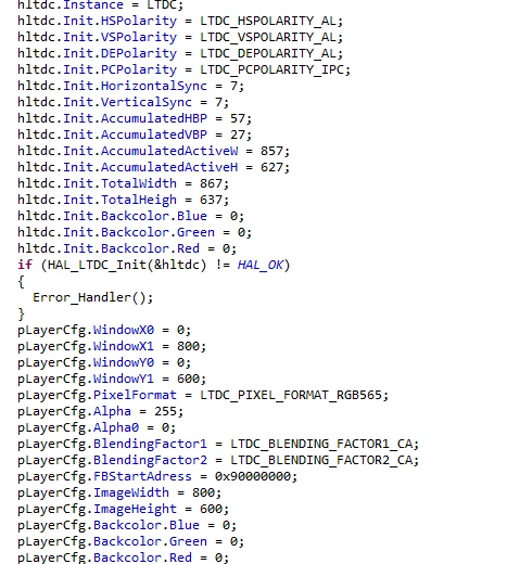

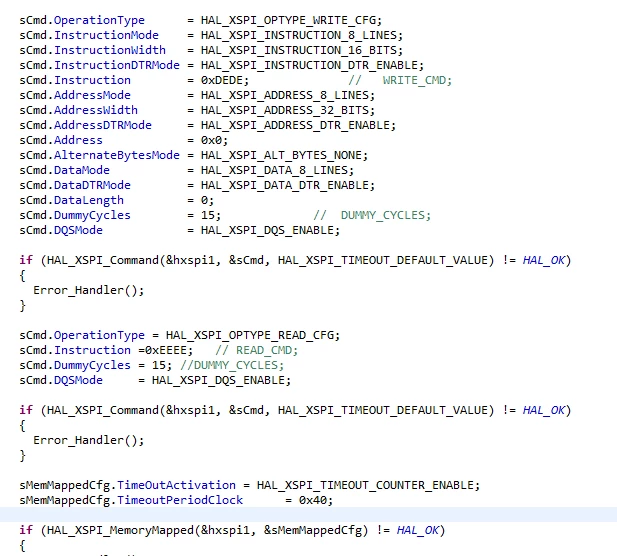

I am working with the STM32N657X0H32Q and configuring the LTDC with external memory. I am facing an issue with framebuffer writes.
The external memory is connected to XSPI Port 1, and the read and write operations work correctly in Memory-Mapped mode at address 0x90000000. I am able to read from and write to this address without any issues.
However, when I configure the LTDC to use the framebuffer at 0x90000000 with a resolution of 800 × 600, I observe that some bytes are missing or skipped during the framebuffer write operation.
For example, I observe that approximately 1 KB of data is written, followed by around 300 bytes being skipped, and this pattern continues.
Memory Configuration

Framebuffer Declaration
__attribute__((section(".screen_buffer")))
uint16_t screen_buffer[800 * 600 * 2];

Could someone please help me understand the following:
  1. Why is the LTDC skipping or missing approximately 300 bytes after writing around 1 KB?
  2. Could this issue be related to the LTDC burst size, AXI configuration, external memory configuration, or framebuffer pitch/stride?
  3. Are there any specific LTDC or external memory settings that I should verify when using 0x90000000 as the framebuffer address.
  4. Could this behavior be related to cache, memory attributes, security/privilege attributes, or memory alignment?
The external memory read/write operations work correctly when accessed directly in Memory-Mapped mode. Therefore, I would like to understand what changes when the LTDC becomes the master accessing the same framebuffer.
I have attached the relevant LTDC configuration and external memory/Memory-Mapped configuration for reference.
Any suggestions or guidance on the registers or configurations that I should check would be greatly appreciated.
Thanks in advance for your help.

Aug 12, 2026 11:06 AM UTC
How do you measure the writing/skipping?
The porch pixel values on your LTDC are also clocked on the output, but they do not contain any pixel data, could that be the source of your skip?
