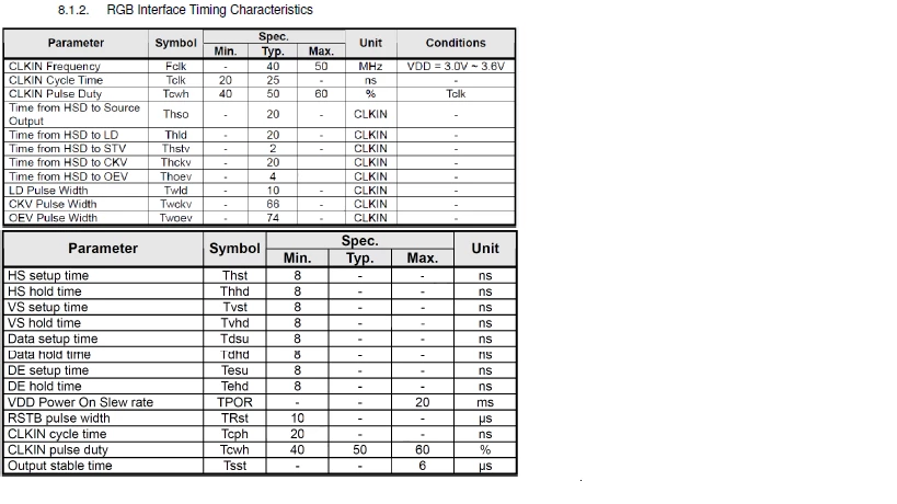

LTDC Clock was running at 40 MHz.
My TFT Requires typical 40 MHz Dot Clock.
Here is my TFT Timing.0693W000006HIqIQAW.pngHere is the timing values i've programmed.

Is there anything that i can try?
MM..1
January 1, 2021
No your LCD define only MAX and TYPICAL and no MINIMAL value, you can use any freq up to 50, but
speed need corelate with MCU. Then try slow down LTDC clock for example -5%. 8)
