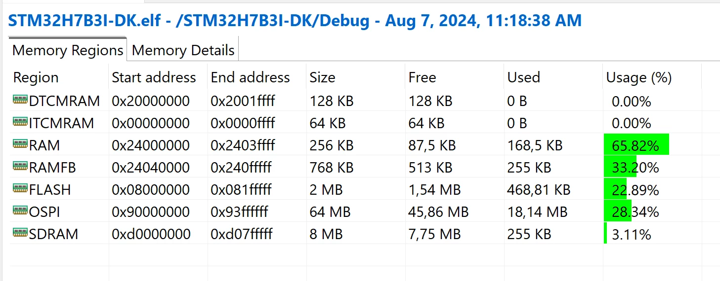

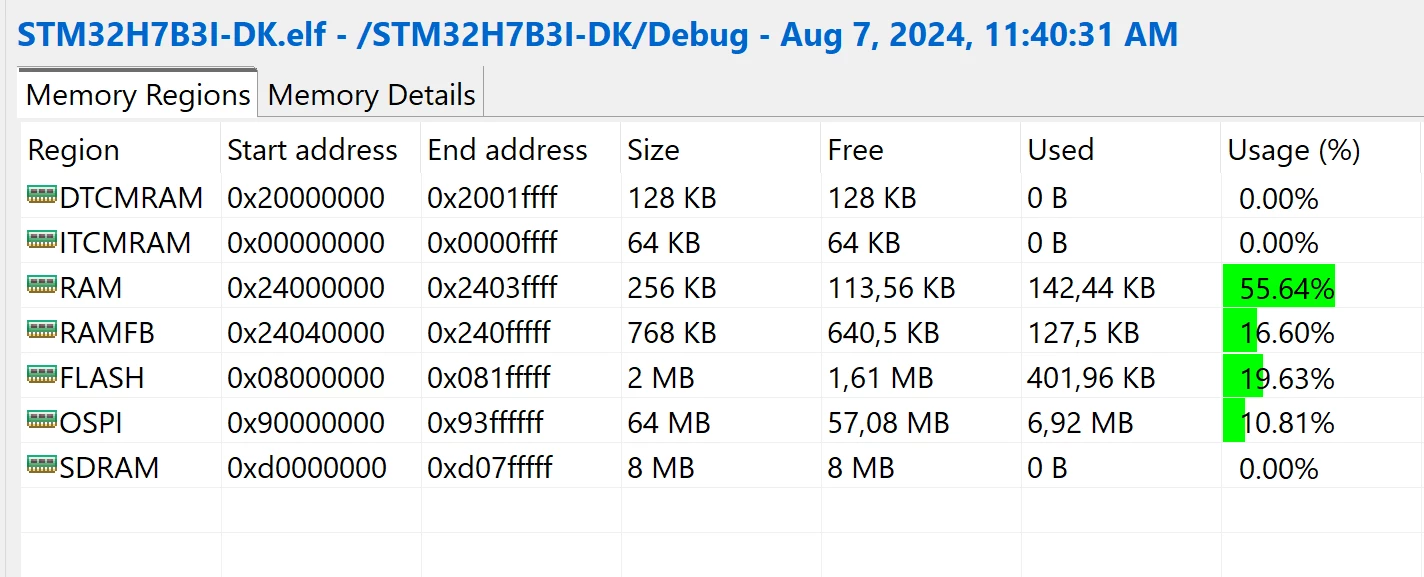

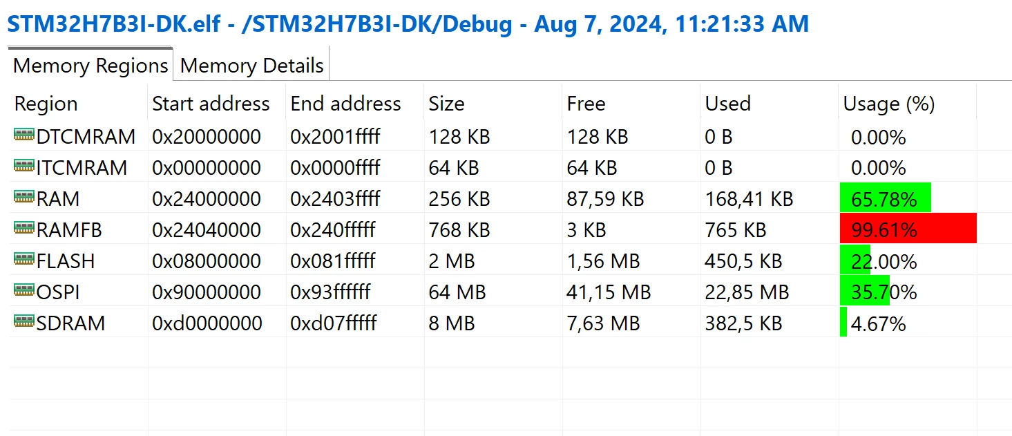

August 7, 2024
My sincere apologies for making a mistake. I totally forgot that the Partial Framebuffer requires GRAM to work, and in my mind, I thought it is possible to just send a section of the framebuffer to LTDC which is far from reality. That is the reason why you were not able to do it. Again, I'm really sorry for my mistake.
If you're using the Board Setup available for STM32H7B3I DK in the TouchGFX Designer, you can decrease the Pixel Format from RGB888 to RGB565, and use single framebuffer.
You can see the difference between running the Smart Home Demo on RGB888 with double framebuffers and RGB565 with single framebuffer below:
RGB888 + Double FramebufferRGB888 + Double Framebuffer
RGB565 + Single FramebufferRGB565 + Single Framebuffer
For an extreme case, you can even set RGBA2222 (8bpp) which results in the following memory usage, however, the quality of the graphics might not be acceptable
RGBA2222 + Single FramebufferRGBA2222 + Single Framebuffer
