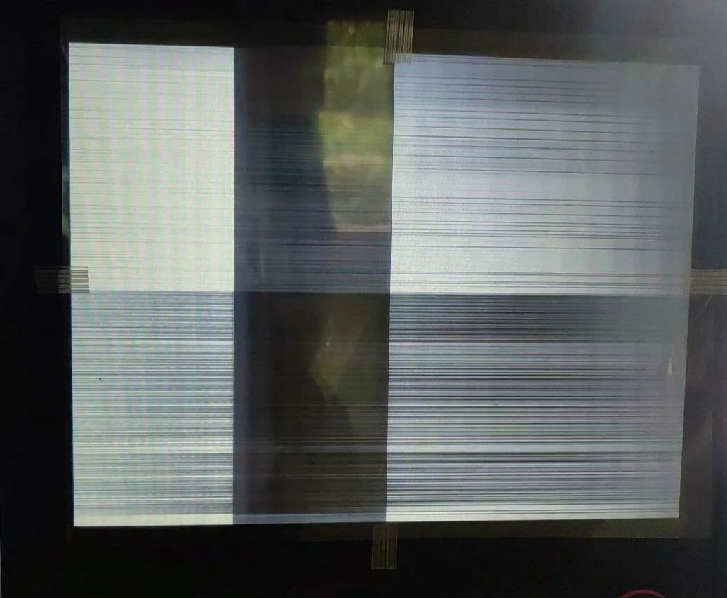

I am working on a custom LCD project using STM32h753 Eval 2. Currently i dont have a tremendous knowledge in LCD. I tried to follow the example codes and some tutorial but not able to make it work. can you suggest any resource or steps to get started?
i am using a custom 1024*768 LCD. This LCD receives signals through LCDT. the config given by the manufacturer is
#define PanelHSyncWidth      43
#define PanelHSyncBackPorch   29
#define PanelVSyncWidth      6
#define PanelVSyncBackPorch   34
#define PanelHStart      (PanelHSyncWidth+PanelHSyncBackPorch)
#define PanelVStart      (PanelVSyncWidth+PanelVSyncBackPorch)
#define PanelWidth      1024
#define PanelHeight      768
#define PanelHTotal      1344
#define PanelVTotal      806
#define PanelMaxHTotal      2048
#define PanelMinHTotal      1120
#define PanelMaxVTotal      1024
#define PanelMinVTotal      776
#define PanelDCLK      65
#define PanelMaxDCLK      71
#define PanelMinDCLK      52
when i try to modify the example code with these data, i was able to get the LCD ON but did not get the expected result. 0693W000003RQj9QAG.jpg
this is what i get when i change the sync config and clock. what are all the possible reasons where i am messing things up?

Hello @UPa.1​ ,
Have a look on this AN4861 Application note LCD-TFT display controller (LTDC) on STM32 MCUs, this may helps you to configure your project.
Best Regards
Imen

October 12, 2020
Thank you. it seems like the problem was with the custom LCD. its solved now.
