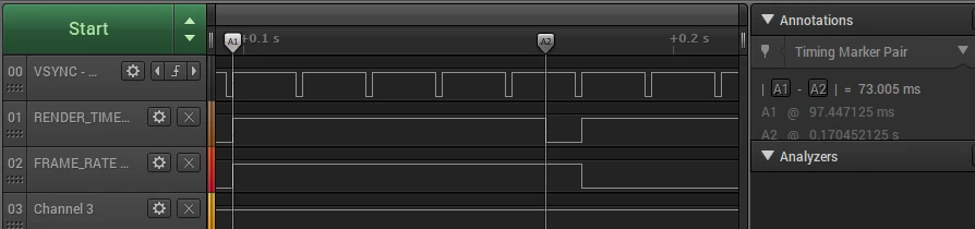

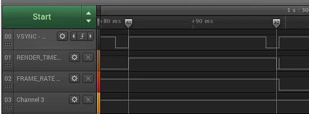

Marco.R
Marco.RAuthor
Senior
Nov 21, 2019 8:49 AM UTC
Hi @Martin KJELDSEN​
Thank you for your reply. Here are some more information
Hardware-Setup:
  • STM32F767 with external SDRAM / QSPI-Flash
  • ChromART (DMA2D) is enabled
  • LCD with 800x480 Resolution (LTDC - RGB565)
We are using embOS and created the project initially with TouchGFX 4.9.3.
The rendering time for a static frame with 4 buttons without images is about 15ms. With the moving images like above the rendering time is >70ms. The 30ms from the first post where with some optimization (only one wave,...)
I've made a more detailed analysis (see attached excel file). There are 5 "delays" with more than 7ms where the TouchGFX Library is doing something but I don't know what. Do you have any idea what happens there?
I would highly approciate, if you could invest some time for investigation. I can provide you more information if necessary, but I can't share the project within the forum.
Thank you very much
/Marco

Nov 22, 2019 6:50 AM UTC
I found the reason why it takes so long. Because of the large images I use, I stored the images as L8_ARGB8888. When I change back to RGB565/ARGB8888 then the method setupDataCopy will called as expected. The rendering time falls from 73ms down to 42ms which is still high but much better. The cpu load falls from >90% down to 4%.
Is there a workaround to use L8_ARGB8888 and DMA2D together?
As written above the rendering time is still high. But I think It makes sense. I tried to calculate the theoretical renderingtime
Read from QSPI (108MHz):
Img1/Img2 (800x250px / 4Byte/px) -> 14.8ms each
Write to SDRAM (16bit data bus / 108MHz):
Background (Box / 800x480px) -> 3.6ms
Img1/Img2 -> 1.9ms each
In total it should take about 37ms. Is my calculation correct?
According to your experience is a rendering time of about 40ms expectable? Or should it go faster?
Do you have any advices how I can optimize the rendering time for large images?  Should I may caching the images into the SDRAM instead of reading out of Flash?
Thank you
Marco
