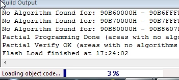

when ExtFlashSection and FontFlashSection are commented (disabled), system loading is OK.
But if these sections are not commented (enabled, written like I quoted) - I get error;
on this stage
I get this error
What's wrong in my SCT file or other settings?
My IC is STM32h743B.
On project for STM32F746B this porblem not occured.

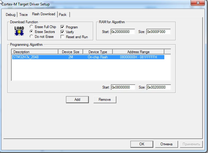

You'd have to have the right QSPI Flash Algorithm selected in the Debugger's Flash settings tab covering the area in question, ie 0x90000000 / 32MB
February 9, 2021
Hmmm...
I don't want to program qspi flash - it is already programmed.
I deleted algorithm from debugger's flash setting tab.

Perhaps you could make it a NOINIT section? Use objcopy post-link to remove unwanted sections?
Or perhaps uncheck "Load Application at Startup" and use a debugger script to LOAD the different sections.
In more considered systems the resource data is exported as a separate file, and the application indexes into it like a file system.

That's the internal flash, you need to select the algorithm to use for the QSPI residing at 0x90000000 (32MB or whatever)
Mathew Grabau
February 12, 2021
Only if they want Keil to flash it. I have no issues with mine (it is flashed separately to Keil to speed download speed). I still specify the section and it works fine (just doesn't program it).

Which debugger are you using? That makes a difference in the answer. I've used Keil with a J-Link and had no issues loading.
February 12, 2021
I use ST-Link
I try different version of ST-Link - China clone, ST-Link from Discovery board.
Drivers - last version, firmware of ST-link - last version,
