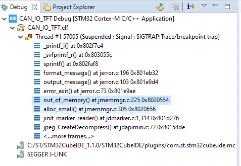

KIlia.1
KIlia.1Author
July 14, 2020
Or i am using an other version of some tool (touchGFX etc).
I think i found the example you are talking about, i ported the libjpeg and the common files but the code gets stuck in
 JPEGFileLoader::getJPEGDimensions(f, width, height);
I am using the same cash configuration as in bitmap.
Is there some other cash/memory configuration i have to make ?
Martin KJELDSEN
Principal III
July 14, 2020
The example i uploaded was only tested on windows / simulator. Pretty sure our demos from the designer use dynamic images (jpegs) - i don't have time to check myself right now
/Martin
