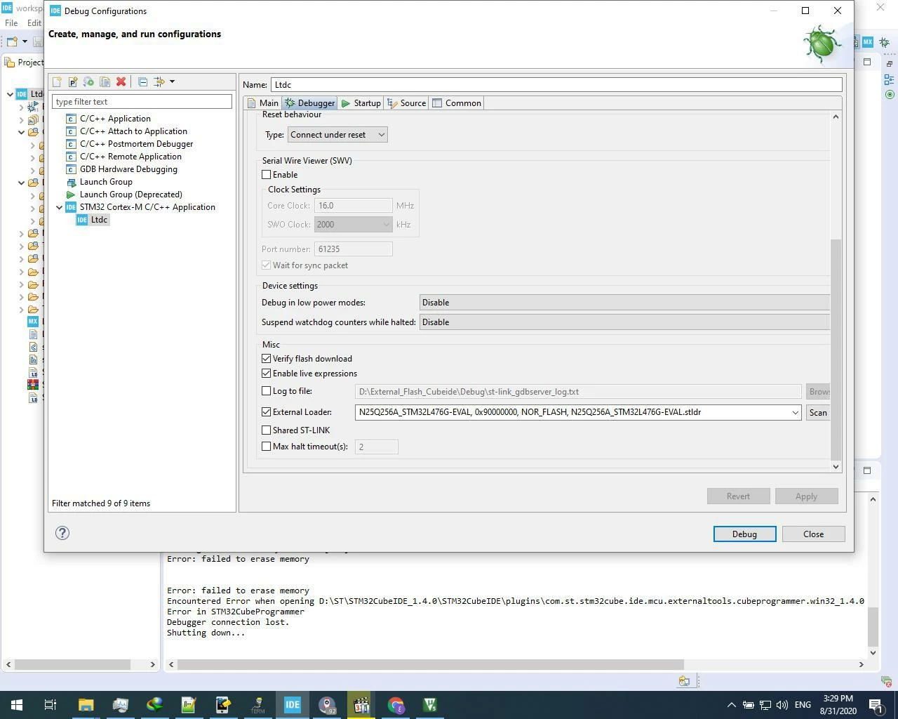

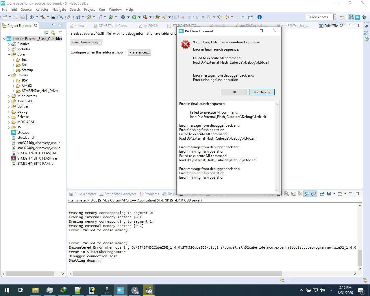

My problem is I can not widgets load to 25q256 via qspi I do not know what the problem is in my program, I put the project for you to find the problem, thanks

I'm not using CubeIDE, I'm not building external loaders with it, and you can't "debug" them in the classic sense.
You'd have to build a test harness to exercise the code.
I don't think you can just slap the L4 example into the middle of an existing project.
I mentioned earlier in the thread that you can build a mechanism into your existing project that can program the QSPI. It for example could detect that the QSPI content is not correct, and enter a loader mode, that could for example pull data from an SD card, or X-MODEM over a UART.
I think one of the TouchGFX app notes suggests something like this. Board bring up blog cited earlier.
Here, at the very least you'd need to implement Erase / Write code for your Winbond W25Q256 devices.
Not sure what local resources you have for training, senior colleagues with loader experience, or contractors/consultants,.

If you're going to use CubeIDE: latest version comes with OpenOCD with stmqspi driver for external NOR flash built in. All you'd have do is to adjust ist the pin initialization (for proper AF setting) and the flash initialization. For that a good starting point is:
http://openocd.zylin.com/#/c/4321/7..9/tcl/board/nucleo-h743zi.cfg
Unfortunately ST had squeezed the setups for various disco boards into the single file stm32h7x.cfg ... So the stuff related to the disco boards has to be replaced by the config for your board. Would have been easier if ST had kept separate file for each board :(
