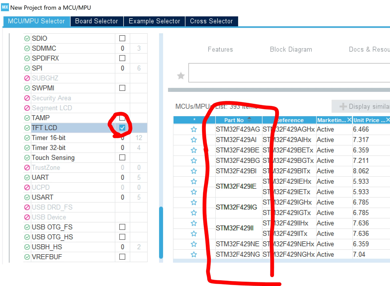

List of ST MCU with LTDC (LCD Parallel interface 16-bit).
I want a list of TFT enabled MCU
TDKBest answer
July 13, 2021
Use the MCU selector in STM32CubeMX and filter for TFT LCD. There are 393 hits.
4 replies
TDKBest answer
July 13, 2021
