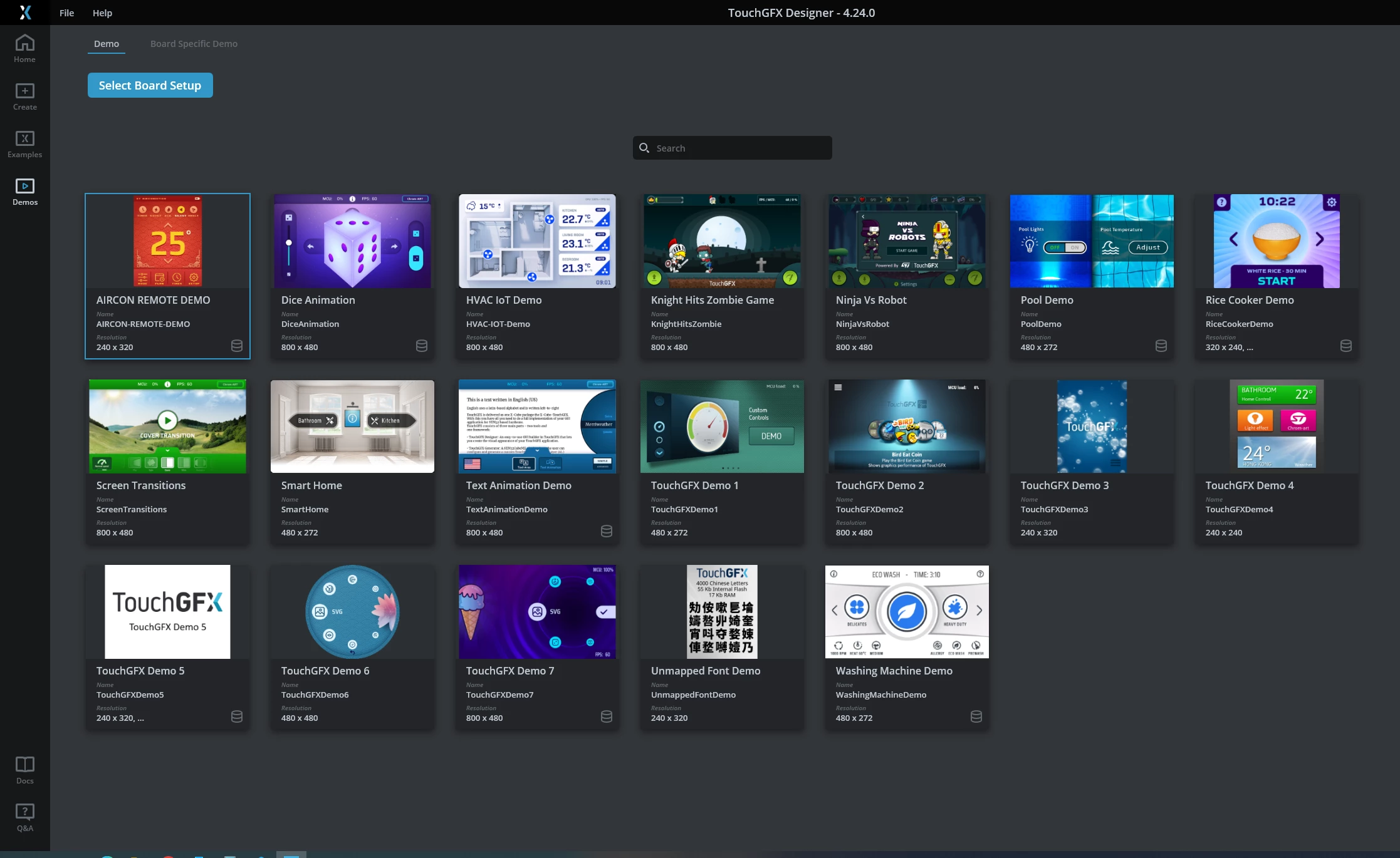

Hi, I would like to create a list menu where the hardware buttons are used to go up and down and a black box indicates the current selection. Does anyone have a solution? Thanks

Hello @salcim23 ,
You can take a look at these available demos in the TouchGFX designer to draw inspiration from them:
  • Aircon Remote Demo
  • Rice Cooker Demo
  • TouchGFX Demo 5
They all support navigation with the joysticks that are available on X-NUCLEO-GFX display shields, like X-NUCLEO-GFX01M2
Demos available in the TouchGFX designerDemos available in the TouchGFX designer
I hope this helps you. Don't hesitate to ask more questions!
