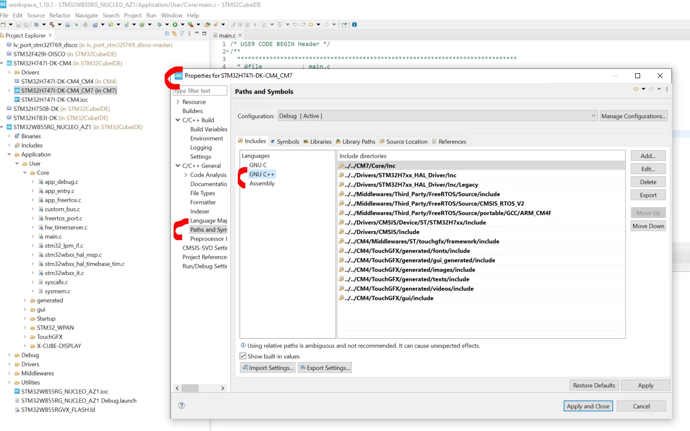

But another issue, I've succeeded by running on target from TouchGFX Designer but when I import the project in CubeIDE, there is another error :
c:\st\stm32cubeide_1.11.0\stm32cubeide\plugins\com.st.stm32cube.ide.mcu.externaltools.gnu-tools-for-stm32.10.3-2021.10.win32_1.0.100.202210260954\tools\arm-none-eabi\bin\ld.exe: ./Application/User/generated/Screen2ViewBase.o: in function `Screen2ViewBase::Screen2ViewBase()':
C:/TouchGFXProjects/test_functional/CM7/TouchGFX/generated/gui_generated/src/screen2_screen/Screen2ViewBase.cpp:28: undefined reference to `video_SampleVideo2_800x480_bin_start'
videos/VideoDatabase.hpp is include in Screen2ViewBase.cpp and I can go through the video_SampleVideo2_800x400_bin_start declaration by "Ctrl + click" on the cpp file.
Can you help me or should I contact their support also ?
Thanks !
Romain DIELEMAN
January 13, 2023
This seems to me like a path missing issue in STM32CubeIDE. Even if the files does exist and the include is correct in the code, STM32CubeIDE may not know how/where to look for it. So you need to go to the properties of your project (right click on the name of your project on the tree view on the left), and navigate to the path and symbols section. The screenshot is just to show you were to navigate, try to add to your project as a path maybe ../TouchGFX/generated/videos/include if it is not already included
0693W00000Y88wZQAR.pngThe video_sample..._bin_start initialisation is in VideoDataBase.hpp in the generated/videos/include/videos folder so that is why i would first look there.
