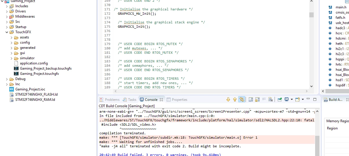

hi everyone,
i wanted to create a project with touchGFX but there are errors, i just create the graphic interface, i didn't add any code!
even though when i tried to upload to my card an example it said error too!
how can i resolve this?

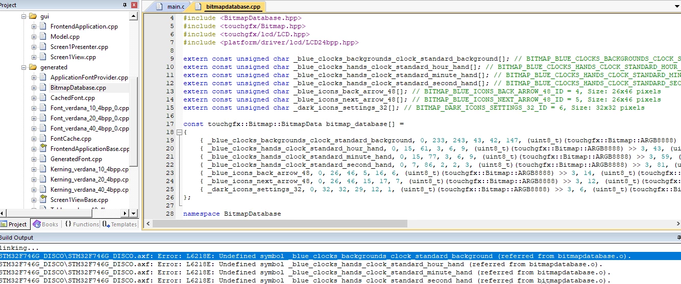

Please show me the log from the designer on why "run target" fails - Which board is this? You need ST-Link installed, and you haven't, is my guess.
As far as your linker issues - Looks like the generated image code has not been added to your project. This looks like Keil - Did you simply start from an Application template? The "Generate" code button should update the project with new files but you can add them manually - I'm not sure what could be wrong with that - but "Generate code" will fail if it cannot execute its "post generate command".

i use the F746G-disco board, I have cubeProgrammer installed, I found the trick but now i have an other problem, PostGenerateCommand "echo test" i put.

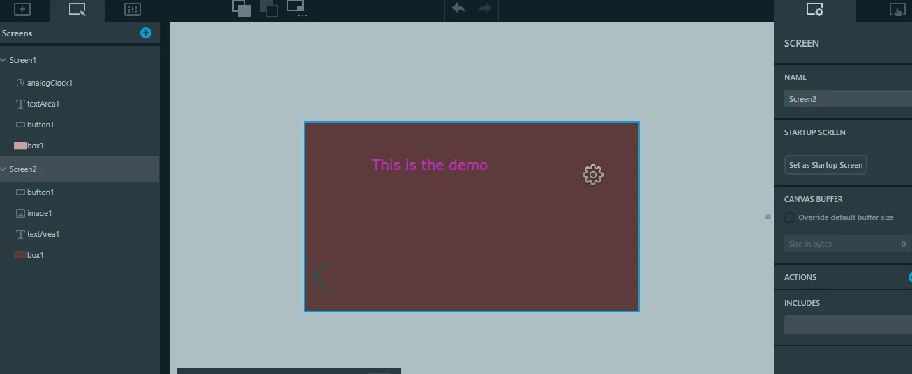

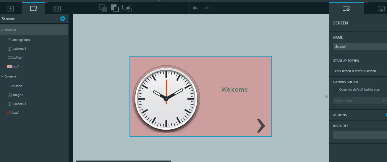

so, I created a project on cubeIDE, I added TouchGFX on the middleware, then I executed TouchGFX Designer, I created 2 screen to test, Then I opened again Cube IDE, and here the errors.
I use Cube IDE 1.0.2 and touchGFX 4.13.0
N.B.: I tried to exclude simulators files as someone did on a tutorial but it didn’t work!

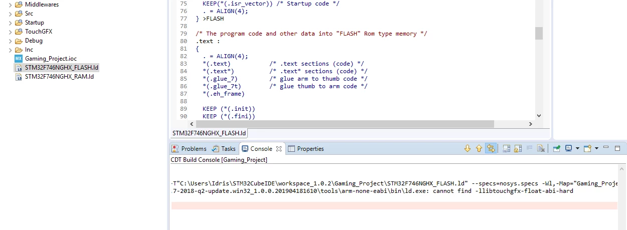

I got 1 error now, please help, I can't understand how to make .elf
It said cannot find -llibtouchgfx-float-abi-hard

There's a linker error somewhere - Can you show me a bit further up the log window?
/Martin

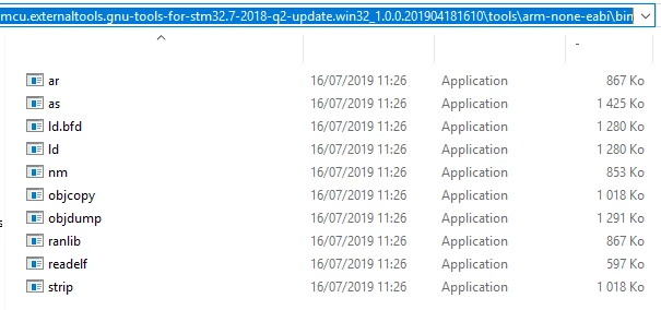

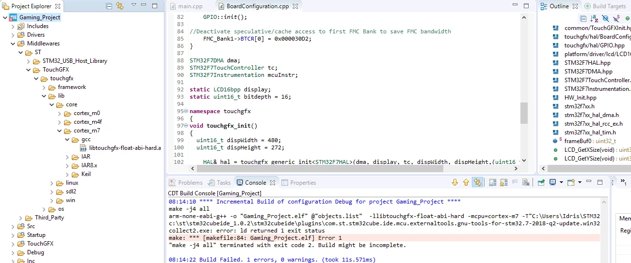

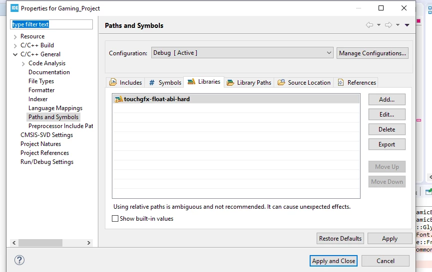

14:39:21 **** Build of configuration Debug for project Gaming_Project ****
make -j4 all
arm-none-eabi-g++ -o "Gaming_Project.elf" @"objects.list" -llibtouchgfx-float-abi-hard -mcpu=cortex-m7 -T"C:\Users\Idris\STM32CubeIDE\workspace_1.0.2\Gaming_Project\STM32F746NGHX_FLASH.ld" --specs=nosys.specs -Wl,-Map="Gaming_Project.map" -Wl,--gc-sections -static -L"C:\Users\Idris\STM32CubeIDE\workspace_1.0.2\Gaming_Project\Middlewares\ST\TouchGFX\touchgfx\lib\core\cortex_m7\gcc" --specs=nano.specs -mfpu=fpv5-sp-d16 -mfloat-abi=hard -mthumb -Wl,--start-group -lc -lm -lstdc++ -lsupc++ -Wl,--end-group
c:\st\stm32cubeide_1.0.2\stm32cubeide\plugins\com.st.stm32cube.ide.mcu.externaltools.gnu-tools-for-stm32.7-2018-q2-update.win32_1.0.0.201904181610\tools\arm-none-eabi\bin\ld.exe: cannot find -llibtouchgfx-float-abi-hard
collect2.exe: error: ld returned 1 exit status
make: *** [makefile:83: Gaming_Project.elf] Error 1
"make -j4 all" terminated with exit code 2. Build might be incomplete.
14:39:40 Build Failed. 1 errors, 0 warnings. (took 18s.447ms)

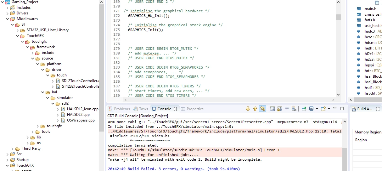

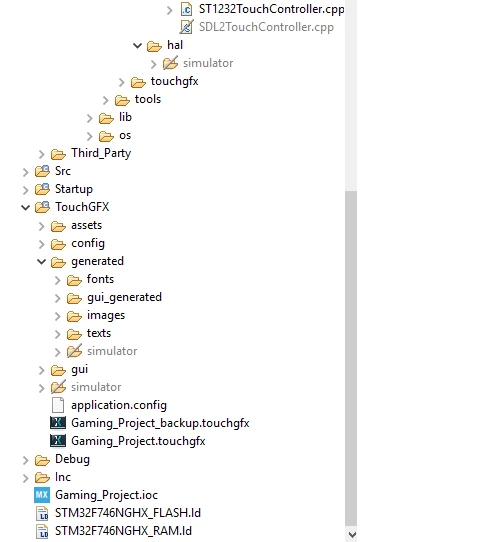

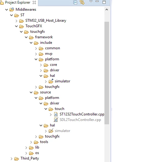

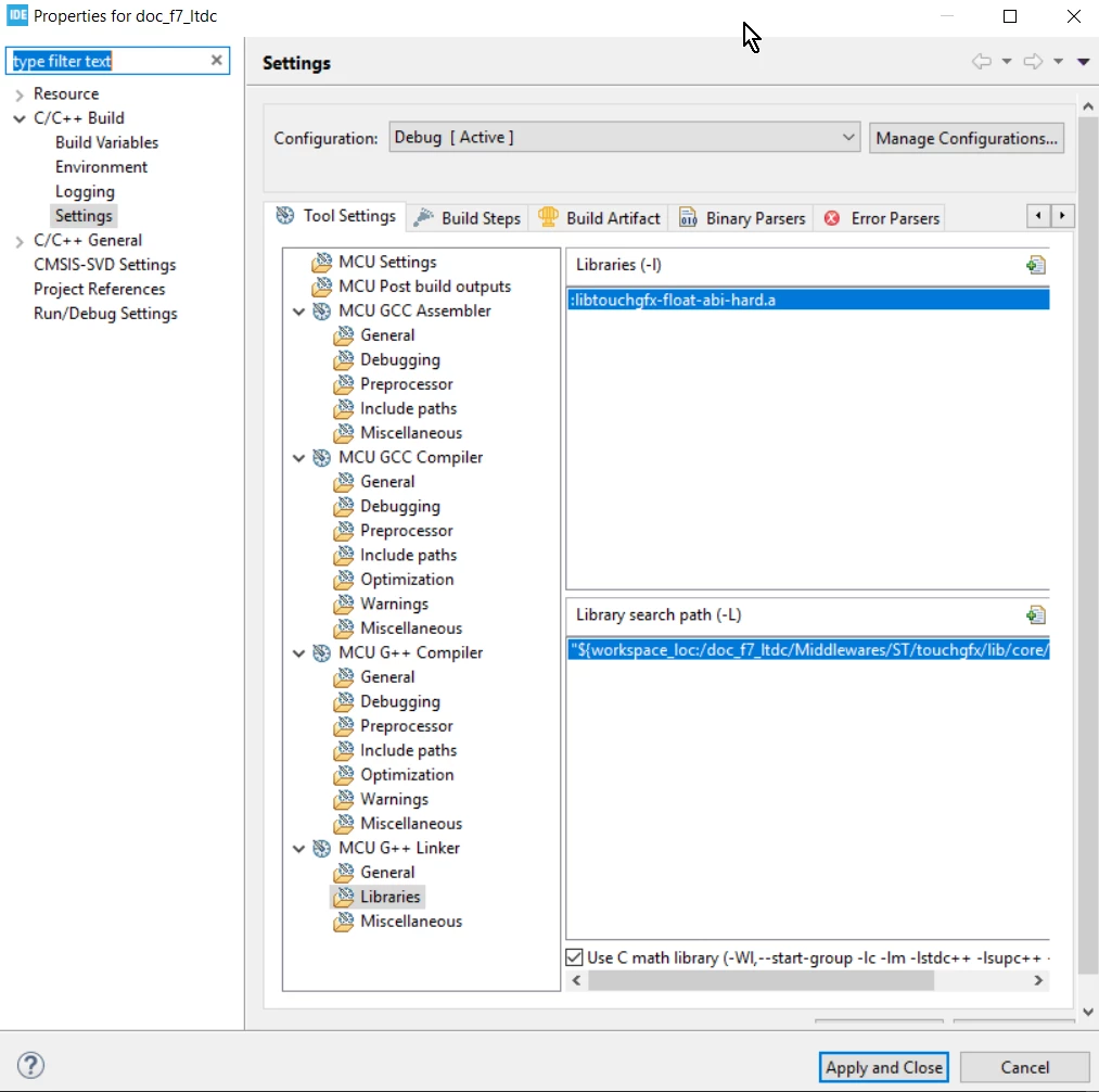

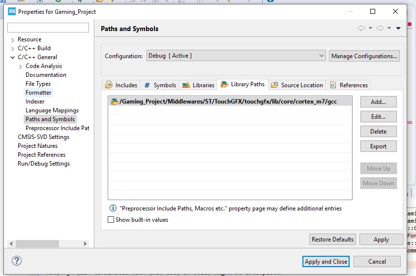

here what i excluded:
here the path I added:
I hope you'll find the error !
Thank you
idrissmc
idrissmcAuthor
Jan 21, 2020 2:37 PM UTC
I found it i add it but it still the same error
Martin KJELDSEN
Principal III
Jan 21, 2020 9:10 PM UTC
Just created a project that links fine (CubeIDE 1.2.0)
* CubeMX Project Generator - Toolchain: CubeIDE
* Generate code
* Open part-file in TouchGFX Designer - Generate code
* Refresh project in CubeIDE and build

i can now debug into QSPI, but when I created some images on TouchGFX, I can’t see them on the LCD when I debug but I still see texts and backgrounds made of boxes, only when I add images I can’t see them on the board, what do you think it could be the problem? :thinking_face:
Martin KJELDSEN
Principal III
Jan 31, 2020 9:23 AM UTC
Did you program the external flash? you need to specify a flashloader for that particular chip through stlink or stcubeprogrammer.
