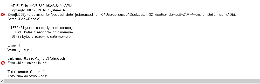

Linker error : no definition for "DATA"(variable of type struct data_t)
I have declared a typedef struct data_t on my jsmn.h
0690X000009Yt5TQAS.pngafter that I declared a variable DATA of type data_t on jsmn.c
and i defined N,T,C and H
then i declared DATA of type Data_t as extern on ScreenViewBase.cpp
and i try to display DATA.N on the screen
but a linker error appear : no definition for DATA referenced from ScreenViewBase.o
PS1: I do the same with time : in ScreenViewBase.cpp I declared extern RTC_TimeTypeDef sTime then  I write Unicode::snprintf(Ndata, 6, "%02d",sTime.Hours ); and it work perfectly.
PS2: I work with stm32f769 and with IAR 8.32.3

Perhaps because DATA isn't very original, and is used as a variable or section name within the namespace of the project, or associated libraries.
Pick something more unique...

Hi @Community member​
I tried that(I replaced with youssef_data) but steel the same problem

Are we sure this is a linker error?
Post a build log, saves playing guess what's wrong.

this is a screenshot of the build log
