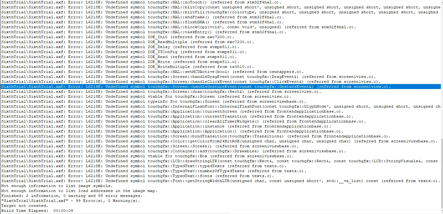

Hey,
I tried generating an empty project using STM32CUBEMX (Followed instructions from: https://touchgfx.zendesk.com/hc/en-us/articles/360021620431-Configuring-STM32F429I-DISCO)

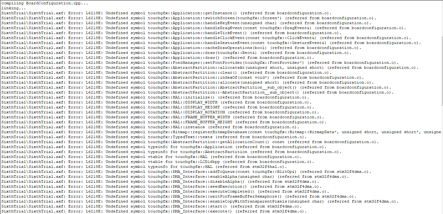

When I try to compile the project in keil I get the following error:
(Sample error line: SixthTrial\SixthTrial.axf: Error: L6218E: Undefined symbol touchgfx::TypedText::fonts (referred from texts.o).)

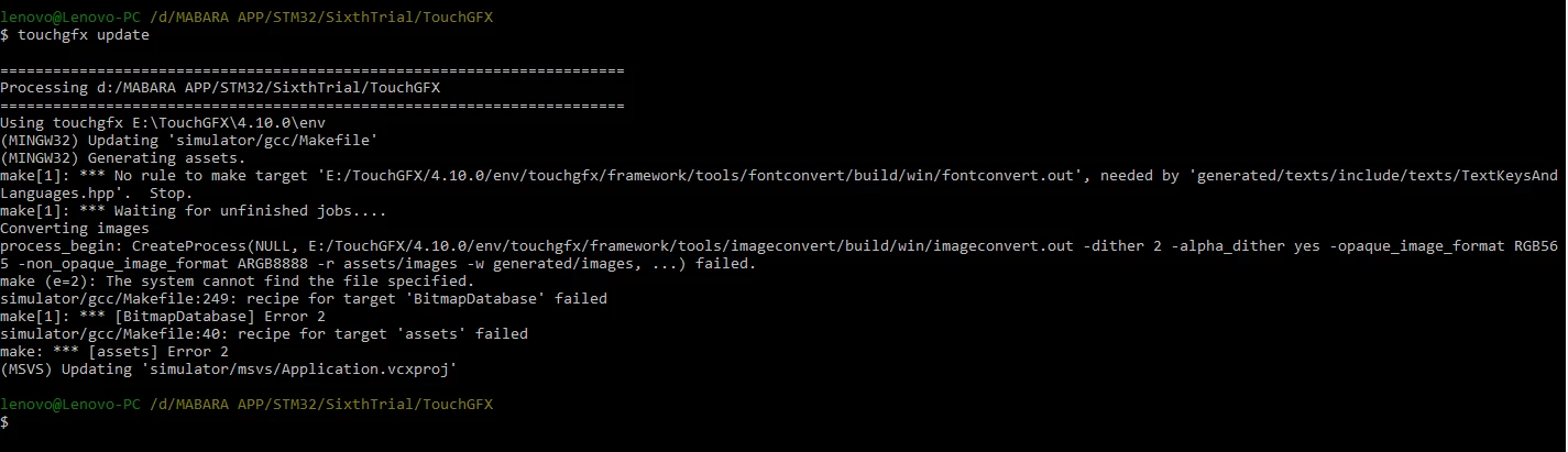

hence after looking up for a few other forums I tried updating my touch gfx in the project folder and got this output:
(Sample error line: Using touchgfx E:\TouchGFX\4.10.0\env
(MINGW32) Updating 'simulator/gcc/Makefile'
(MINGW32) Generating assets.
make[1]: *** No rule to make target )
Please let me know where I am going wrong. Thank You.

Hi. At this time, Keil is not a working compiler for these integrated tools.
Can you switch to IAR or the (free) SW4STM32 toolchains?
Here is a working procedure for both IAR and SW4STM32 using this target kit:
https://community.st.com/s/question/0D50X0000A4pPgPSQU/stm32f2429-disc1-configuration-with-touchgfx-cubemx-50
Hope this helps.

That helped, thanks :D
