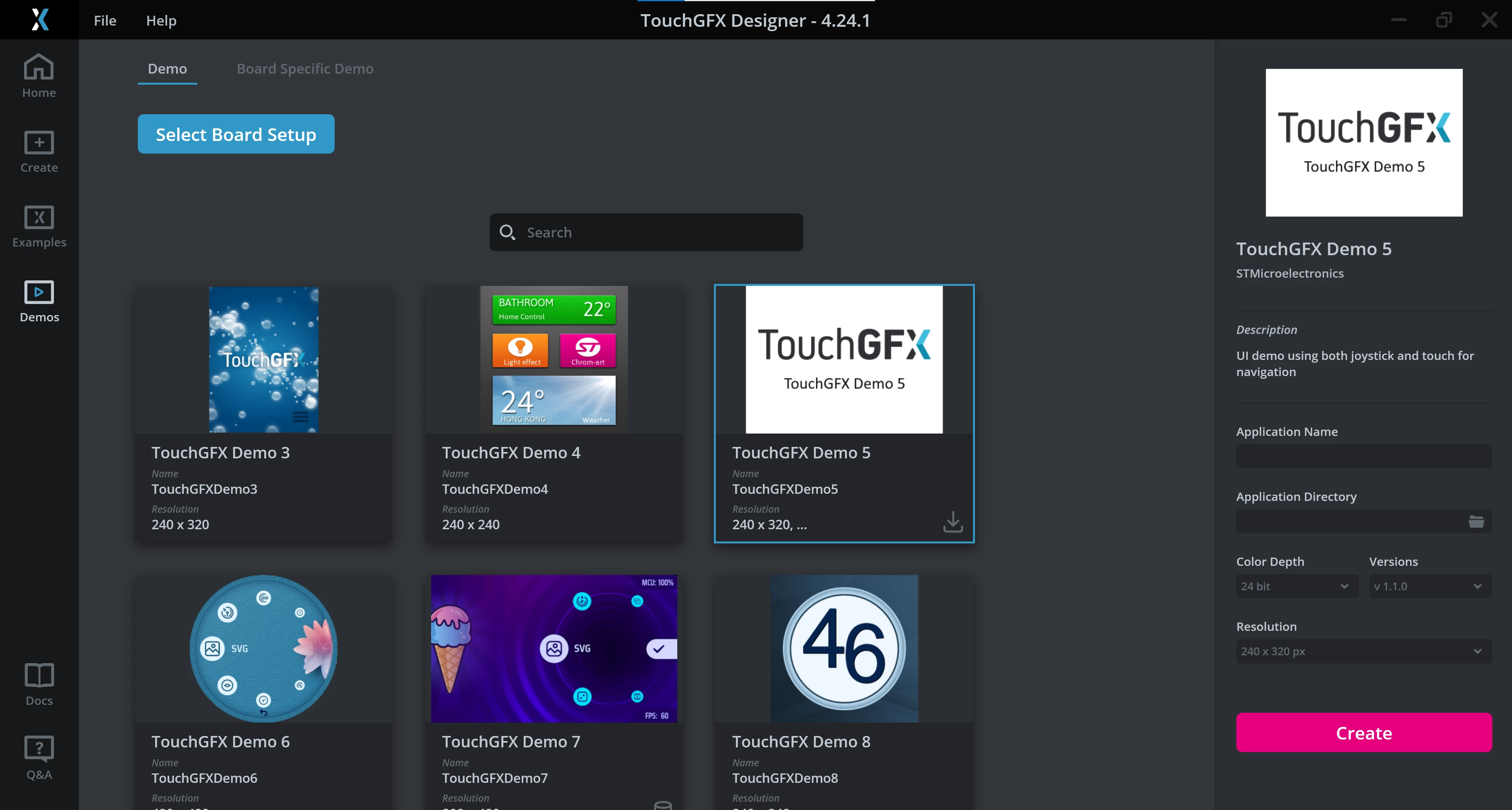

Hello @Kostas Papouis,
You can use Scroll Wheel instead of Scroll List which already supports a functionality to highlight the selected button. You just need to provide the image for when the button is selected.
There are a lot of examples available in the TouchGFX Designer that you can use for inspiration. For instance, you can take a look at TouchGFX Demo 5 in the language selection screen.
TouchGFX Demo 5TouchGFX Demo 5
For your second question, there is no direct way to connect a hardware button to ButtonWithLabel; however, you can simply define an Interaction to happen when a specific hardware button is pressed. There is also example for that in TouchGFX Demo 5.
I hope this helps you!
Don't hesitate to ask more questions if you have any!
