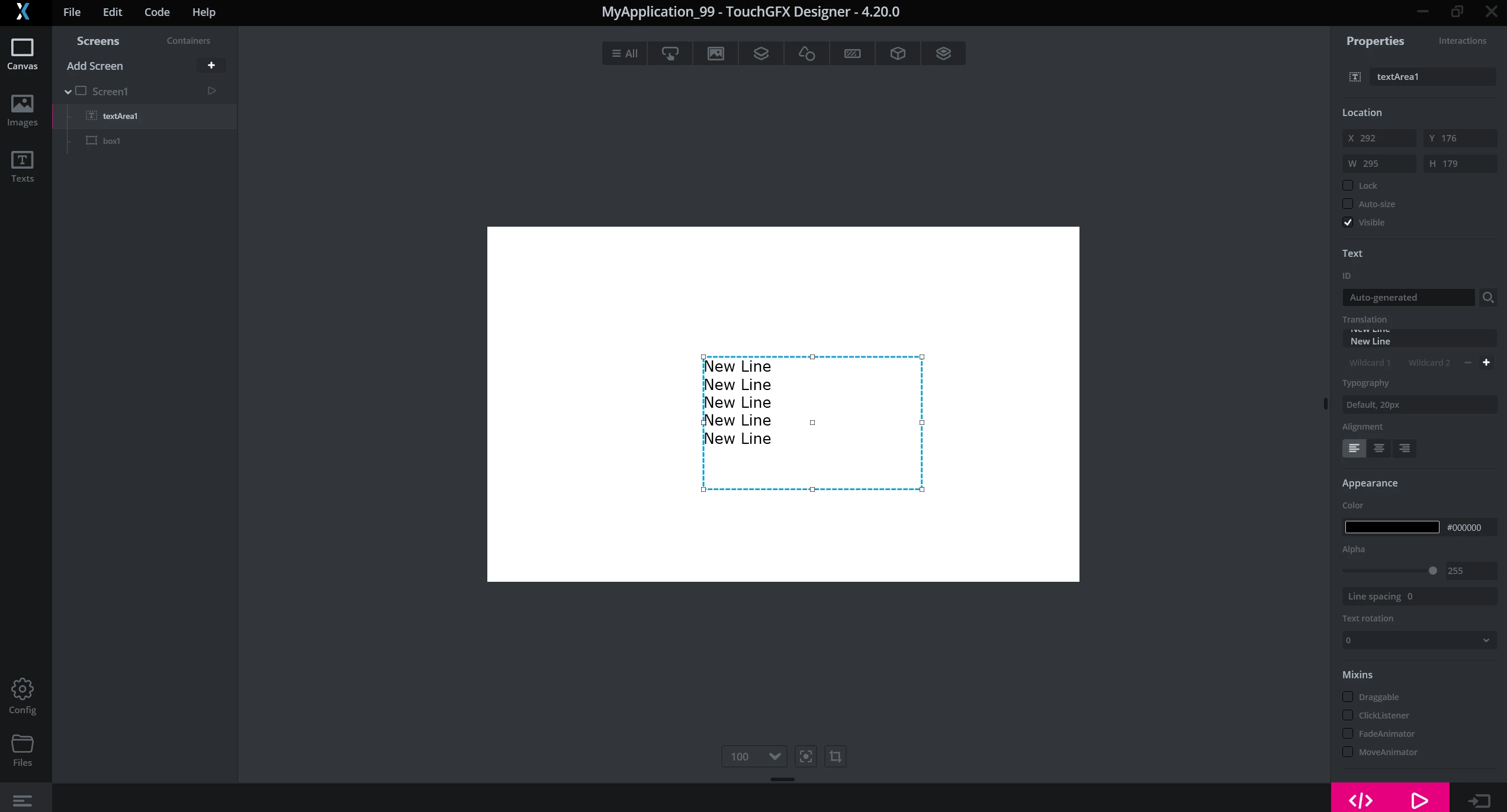

LineSpacing error in TouchGFX Version 4.20.0
I updated my TouchGFX from version 4.18.1 to version 4.20.0 and noticed that it is no longer possible to set the "LineSpacing". In the old version, if you had a text area with several lines, you could increase or decrease the line spacing pixel by pixel using the "LineSpacing" value. If I now change this value in TouchGFX version 4.20.0, this no longer has any influence on the line spacing of the text. Is there a reason why this function no longer works?

Hello IHaas.1,
I tried to reproduce your error without success, the LineSpacing works fine on my side.
With LineSpacing 0 :
With LineSpacing 30 :
0693W00000Nt1qjQAB.png0693W00000Nt1qGQAR.pngCan you show us some screenshots from your application ?

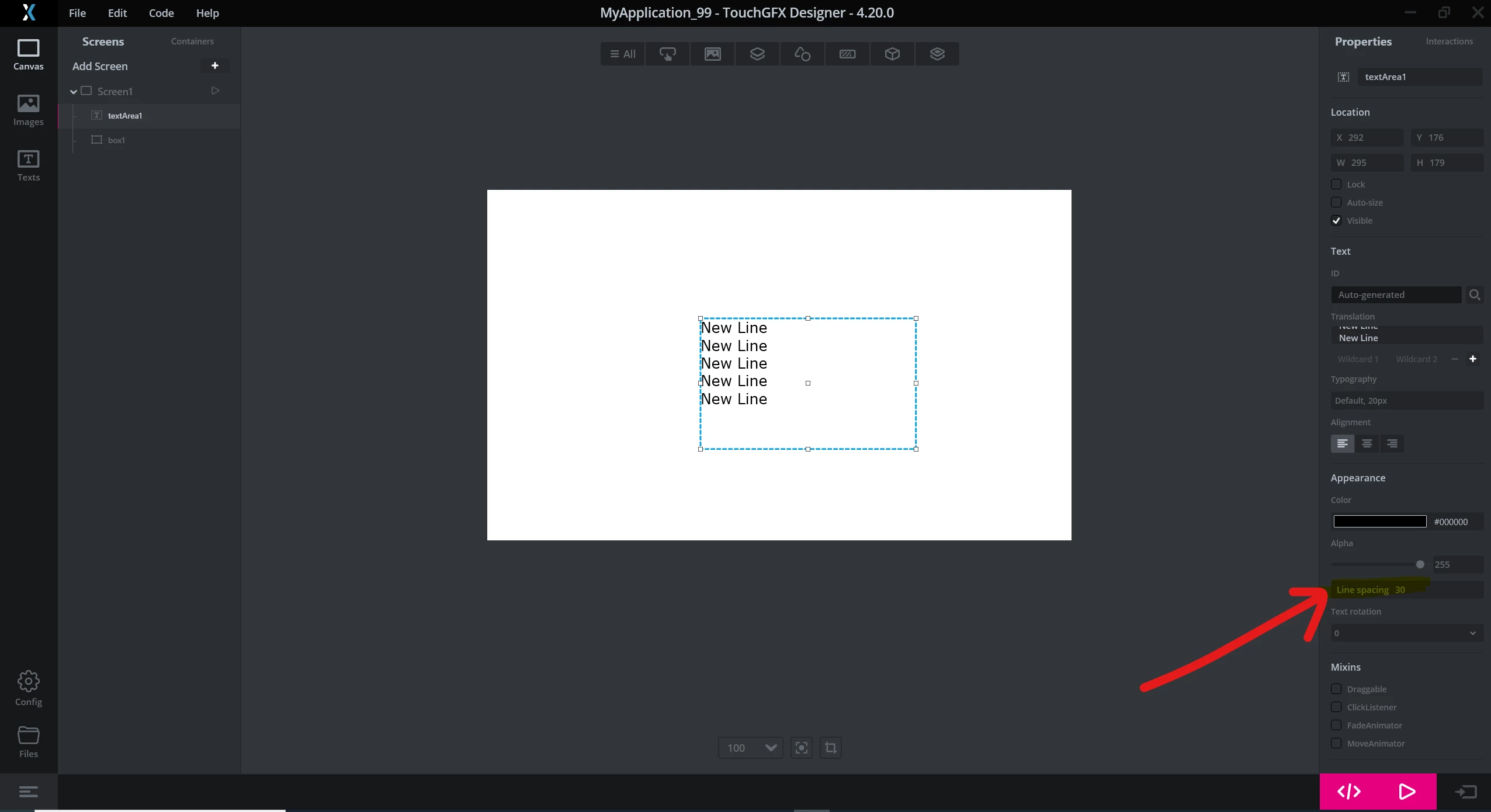

DStau.1
Graduate
Jun 29, 2022 10:15 AM UTC

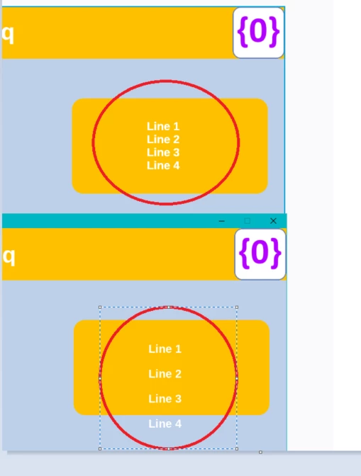

So it translates your spacing on the target but it's not visible in the designer. This seems like a bug since we can't fix the GUI without opening the simulator for every spacing change we do.

Osman SOYKURT
Jul 4, 2022 8:58 AM UTC
Yes you right, the "preview" of line spacing is not working. Thank you for your report. We'll try to have this fixed for the next version of Designer for sure. I'll keep you updated about this, and meantime, you can use the simulator to have this preview.

Osman SOYKURT
Sep 6, 2022 1:37 PM UTC
Hello JSeiz.1,
The latest version of TouchGFX is still the 4.20.0, so the bug is still here. But I'm happy to tell you that we have a fix ready for that, so it should be resolved for the next 4.21.0 release :)
