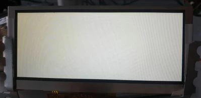

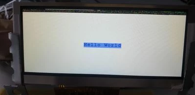

Hello community,
I am trying to show a shape (line) or text on a background a TFT parallel RGB Display. I am using the NUCLEOH7A3 board without external RAM and a 800x320 Display.
Everything works fine using TouchGFX. So it is not a hardware problem or CLK. But I want to program it buy my self using other libraries.
I copied the files and functions from the STM32H7B3i Discovery LCD example (stm32h7b3i_discovery_lcd.c and stm32h7b3i_discovery_lcd.h) and changed them a bit.
The function UTIL_LCD_Clear() works fine (except of weired pixels on the top (line1 or 2)) but the text and the line are not shown. And if I take the function UTIL_LCD_Clear() out, the text and the line are shown but the Display background looks weird with weired pixels. (see images)
So why the text and the horizontal line are not showing after filling the screen with UTIL_LCD_Clear()?
(Nevermind about the horizontal line now. It had another color, that I could see. But now because I've already made the pictures, I can ensure you that the line can be shown like the text.)
Am I missing something? Does the FBStartadress (initilized with AXI SRAM1) need to be changed each time you want to show something else on the display? (I thought the functions increment the adress automatically, so I think it is not a problem of the RAM adress...)
Thanks alot ! I appreciate your help!

Feb 6, 2024 12:35 PM UTC
I found out the problem!
Variables were saved in the same memory, that I starded from (AXI SRAM1).
The display is 800x320 and I used ARGB8888. So the hole internal 1MB RAM was used. There was a conflict between the variables and the Display pixels written at the same adress.
When I changed to RGB565 and changed the FBStartAdress to AXI SRAM2 everything worked!
